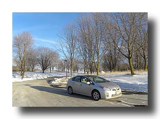

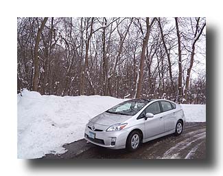

    No pictures with my PHV yet, but it basically looks the same as the 2010 with the same gray foam and squeeze method...
