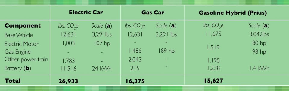

    Okay, I have a real job and I need to get back to doing it, but here are a few more things I noticed about this study beyond all of the good points made by others earlier:
    Look at Table 9 on page 25. They break out several large components of the car and account for the CO2 by scaling them against chosen "standard" car values. The Electric Car uses values from the 2013 LEAF.
    They appear to assess an overall CO2 manufacturing debt based on the total curb weight of the vehicle. Presumably this accounts for the structural steel of the body etc. However, they calculate this against the full weight even though they separately break-out and account for the engine, motor, and battery pack. Since much of the weight in an EV-centric car comes from the large battery pack I think this means they are double-counting the carbon debt of the batteries.
    They account for the carbon debt of the gas engine by scaling based on HP relative to a conventional gas engine. This undercounts the carbon debt for a Prius-like hybrid because they are using the Atkinson cycle HP of the engine which is lower. For the example of the Prius in Table 9 they use 98 HP but the Otto-cycle version of the Prius engine is rated at 134 HP and almost certainly has an identical carbon manufacturing impact.
    They account for the carbon debt of manufacturing the electric motor but for Prius-like hybrids they are counting only the larger of the two similar motors. They count 107 HP for the LEAF but only 80 HP for the Prius when it also has a smaller 35-40 HP MG. The Prius motor should be counted for carbon debt purposes as around 120 HP.
    The Prius entry in Table 9 estimates a curiously smaller value for "other Powertrain". Why would this value be so much smaller than either the LEAF or a conventional gas car?
    The biggest problem, however, is battery manufacturing accounting. It's a big mess. Let's count the ways:
    1. They think Lithium Iron Phosphate batteries are 26% higher in carbon debt per kWh. The primary study they depend on says Iron Phosphate batteries are about 5% higher (Hawkins, et al. page 5) and other studies say Lithium Iron Phosphate might be a bit lower carbon intensity.
    2. They wrongly think the Chevrolet Volt uses Lithium Iron Phosphate cells.
    3. They base their battery carbon debt on a study of Lithium NMC cells even though almost no production cars today use real NMC.
    3. DING! DING! DING! They fail to tell you that the underlying study they rely on (Hawkins 2012) for the battery manufacturing carbon debt uses values than are 3.6 and 2.3 times higher than other recent studies.
    According to the Hawkins paper:
    The Hawkins paper (and therefore the Climate Central report) uses the high estimate from Majeau-Bettez (since he is one of the authors of the Hawkins paper). The Notter study (the lowest estimate) specifically evaluated the detailed life cycle global warming carbon impact of Lithium Manganese cells which are the closest match to the actual cell chemistry used in the LEAF and Volt.
    The Climate Central report should have highlighted the wide disparity in carbon debt calculations between these papers and explained why they chose to use the highest and rather outlying result. A more honest report would have acknowledged that this is a new area of study and the results have not settled in to a consensus yet. A better approach would be to use a median of the several study results like the LCAWorks synthesis below.
    The next step is to redo the Table 9 calculation for the LEAF, Volt, and regular Prius with more sensible numbers based on the criticism above.

    Reading the text (page 30 of pdf) it seems they have not given a 1.26 penalty to the volt battery (or any other vehicle they though having LiFePO4 chemistry)
    We scaled the battery
    manufacturing emissions in Table 9 by the ratio of the
    battery capacity of the car of interest divided by the
    Electric Car battery capacity in Table 9.

    Look closer... On page 29 of the PDF in the small text under Table 9 it says:
    If you look at Table 9 you will see that they did, in fact, scale the Prius NiHM battery to be 1.8 times their nominal NMC number. What makes you think they didn't also do a special scaling for FePO4 which think is 1.26 times their nominal NMC cell number and which they think is used by the Volt and the BMW Active 3? Table 9 shows a 24 kWh NMC battery as being 11,516 lbs CO2e but for FePO4 they are using 14,488.
