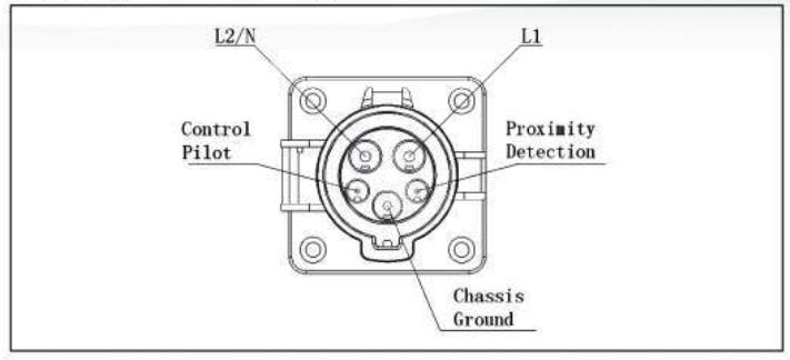

    There are many routines that test to see that it is safe before applying power. One you can see, is that the power connectors are longer than the sense connectors, so the insulators are already protecting you before the computers start chatting and testing to power them on. No chance of open sparks.
