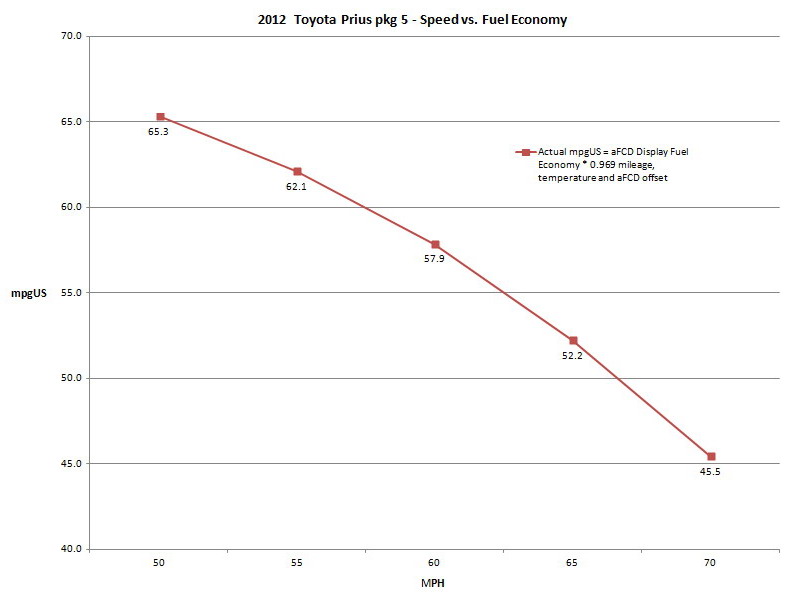

    Here is a steady state MPG for a Third Gen with the 17 inch wheels.
    Robert Holt likes this.
