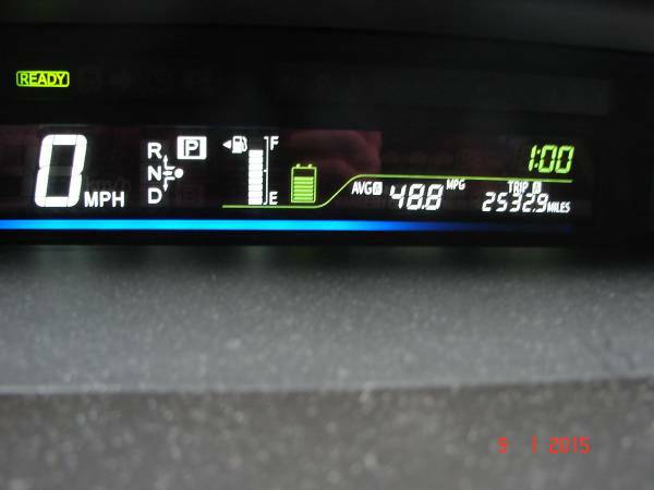

    I have read most of the forums posts about Prius v (lowercase v for the Prius v wagon) mpg. I just want to share my experience and maybe it will be helpful for someone.
    I am car dealer from CA and selling cars overseas. Two years ago, I have received an order to purchase a couple Prius v 5 top loaded. I had to purchase them one after another and ship in sequence. I purchased two Prius v 5 2012 20K and 27K with manufacturing date 02-2012. Cars were just one year old. Both cars had weak EV output and poor 35mpg. Before I shipped them out of country, i drove about 4k miles on one car and on the second one about 1k. I figured that there is just possible design features from the plant of Prius v but I should say that I really like the car.
    Soon after, a couple more cars were purchased with manufacturing date 9-2011 64K and 01-2012 18K. Both cars drove excellent! MPG was about 45-50 and good EV acceleration. Seeing it really changed my opinion about Prius wagon. I decided to buy v for my personal use, but unfortunately i purchased car with manufacturing date 02-12 :-( The one that drive feels like I’m towing a trailer and gives only about 35-36 mpg. Later in will refer to them as “trailer” Prius.
    Maybe owners of “trailer” Priuses haven’t experienced how a good Prius v should drive!
    And they drive their cars just like moving a trailer. Yes, yes! That are the exact feelings. One car is riding freely and another one with trailer behind. Sometimes people who sold (trade) their good car are buying "trailer" Prius. And they are starting to worry about it but sadly no-one listens to them. And there are a lot of people who experienced it.
    I decided not to sell and leave "trailer" for myself hoping that I can find the cause of the mass failure. I started from the beginning: new tires and new oem rims, alignment, complete brake inspection. I switched the complete main battery from same Prius v but without “trailer” issues and with good MPG. I used megohmmeter for inspection MG1 and MG2 and didn't find any issues. I installed different power management control ecu. I changed gas pedal. Replaced inverter (bought used from eBay). Surprisingly, I changed so many things so I can't think of anything else what can be replaced (transmission?). Performance test 0-60 mph results are almost the same for both cars with “trailer” and without. It looks like it is impossible to proof that your car has an issues or has any manufacturing defects since performances 0-60 mph are the same. I am going crazy about it and still trying to resolve this problem. The most interesting is that somebody who should know about this defect is just sitting quietly and doesn't share or explaining what can be wrong.
    One more thing. Since I am a car dealer I can see that on the dealer auctions sometimes they are selling lemon cars from different makers but NEVER I had never seen the any Prius Lemon but know for sure that there are so many cars that moved to the lemon status. I think it opens up even more questions around it, don’t you think?
    Some drivers also reported similar issues and drastically varying performance between different Priuses of the same model and year.
    Has anyone experienced poor EV performance and high consumption with the Prius v?

    Please do not ask me simple questions :) I tried to make it clear at the outset that I have checked all the possible causes.
    Most of the cars that I described were almost new or closed to new condition. All cars had just one driver the one that perfectly runs and the one that doesn’t - so to look for the root cause of it in oil, A/C and tires doesn’t make any sense!
    The difference between the trailer and normal Prius v (lowercase v for the Prius v wagon) is too big that you can’t be attributed on the tires or oil. Prius that was purchased in Oregon 64k 09-11 and didn’t have original tires. It had Bridgestone Turanza Serenity Plus 215/50R17 with OEM tire pressure 33! front and 32! rear. Car ran very nice 50 mpg! I installed that tire set on my car temporary just to validate, but it didn’t change anything :)
    One more time, the problem does not lay on top. People talk about the new cars that they recently purchased, one goes well and the other does not. I am sure most of us agree that the difference between 35 and 50 mpg is too big . We don’t know something and I'm trying to find it and just decided to share with you. I am sure there are some explanation to it, something that can and must be fixed. Hoping for someone that knows something more about this topic.
    PS for all my Prius v (lowercase v) (5-6 cars)
    tire + - 40 front rear, eco on, a/c off, 0w20 mobile1 only, newer towing a trailer :) But my cars 50/50 trailer :-(

    My findings are based not just on two cars but at least on 3 "trailer" cars not to mention that one i still own. I am surprised the reaction i have received but I really did expect it. I think some of you don't have a chance to compare your own car with same Prius but with different performance. I guess you still can force the ‘trailer” Prius to give you 40-42MPG by controlling the way you drive ALL the time. BUT normal Prius will give you 45MPG absolutely without any special control by just enjoying car and driving forgetting all the details. This is important since I experienced it by myself and was surprised!
    Anyway, if this subject isn't interesting for you guys i dont see the point to continue the discussions.

    Short story. Tire + - 40 all battery (main and AUX) checked and swapped
    all cars like new and very clean
    EGR done :) speedometers fine. tire size oem. oil, coolant and all available visible I already checked. no. something hidden from view. non-standard.
    Trailer #1 02-12 20k bought from Manheim Milwaukee auction 12-2012
    Trailer #2 02-12 27k bought from Manheim Atlanta auction 01-2013
    Without trailer #1 01-12 18k bought from Manheim Fredericksburg auction 02-2013
    Without trailer #2 09-11 64k bought from Mountain States Toyota Denver, CO 06-2014
    I forget to mention that on the Trailer 1 and 2 photos with MPG shows not real figures, to get them I needed to drive from the hill for a long time :) real average for 1 and 2 37mpg
