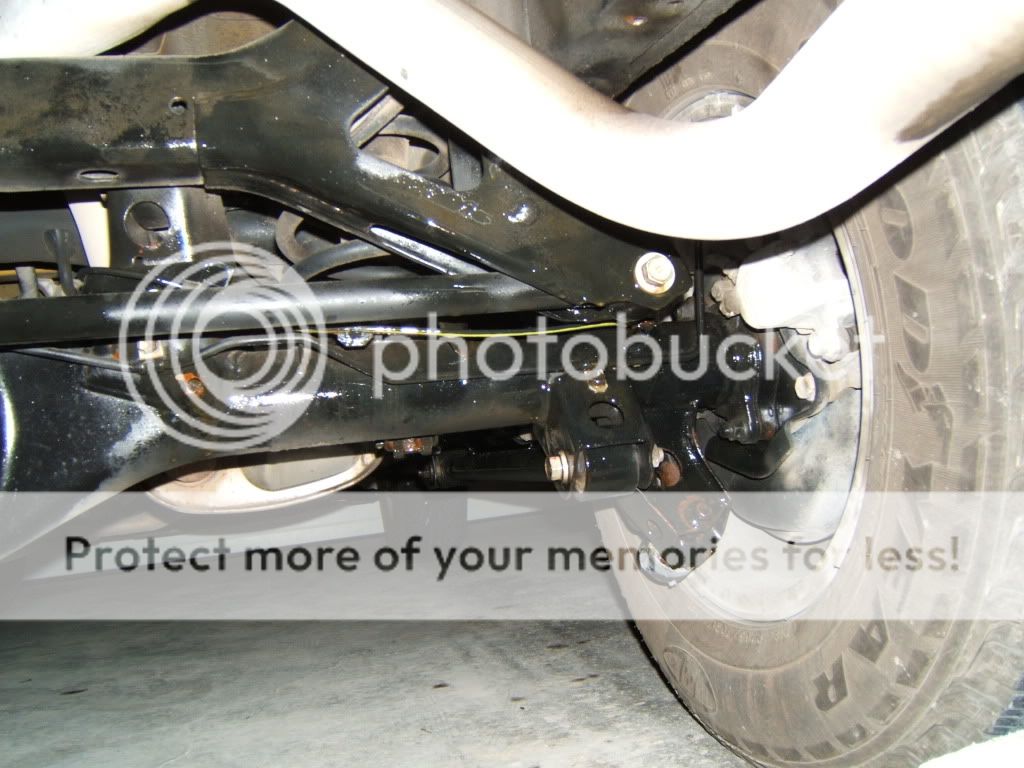

    I used Fluid Film on my Prius. Unfortunately, never thought of taking any photos before I sold it last year. Underneath, it looked pristine except for the exhaust system
    I got my '07 FJ new, and immediately sprayed Fluid Film underneath, into all the weep holes, and inside the door panels. This is how it looked last fall
    I resprayed around two weeks ago
    Fluid Film works.
