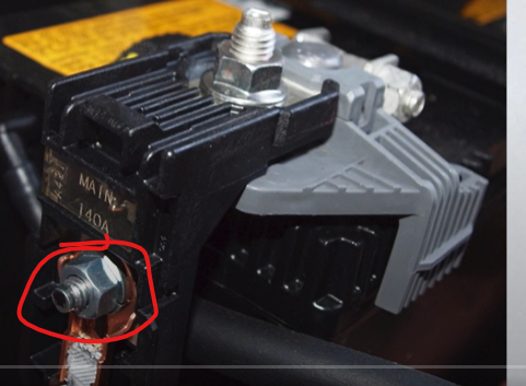

    I recommend attaching your + cable at the car side, not the battery side, of the fusible link that is in the battery + clamp. If you look at this photo (sorry, it was for a post about something else, there's a lot of stuff in it), the fuse link is in the part of the red clamp that hangs down the side of the battery:
    There's a nut and stud on its bottom end there, a perfect place to attach your cable using a ring terminal.
    Located there, your tap is protected by that clamp fuse between it and the battery, and by the front fusebox fusible link between it and the converter under the hood.
    Also, you will pretty much always have the car in READY when drawing much power from your inverter (won't you?), which means the power you're using is coming from the front of the car. By locating your tap between the two fusible links, there is only one fuse voltage drop between you and where your power is coming from. If you attached right at the battery post, there would be two.

    Is this where you mean to connect the fuse?
    I found this tutorial, which I think I will stick to except for the positive connecting point mentioned to be better placed on the car side. So for wiring:
    Yes the car will be in Ready mode. An electric kettle runs at ~750 watts, so I think it will be OK if I only run that, and nothing else.
    Thanks for all the input, and any other tips you might have!
