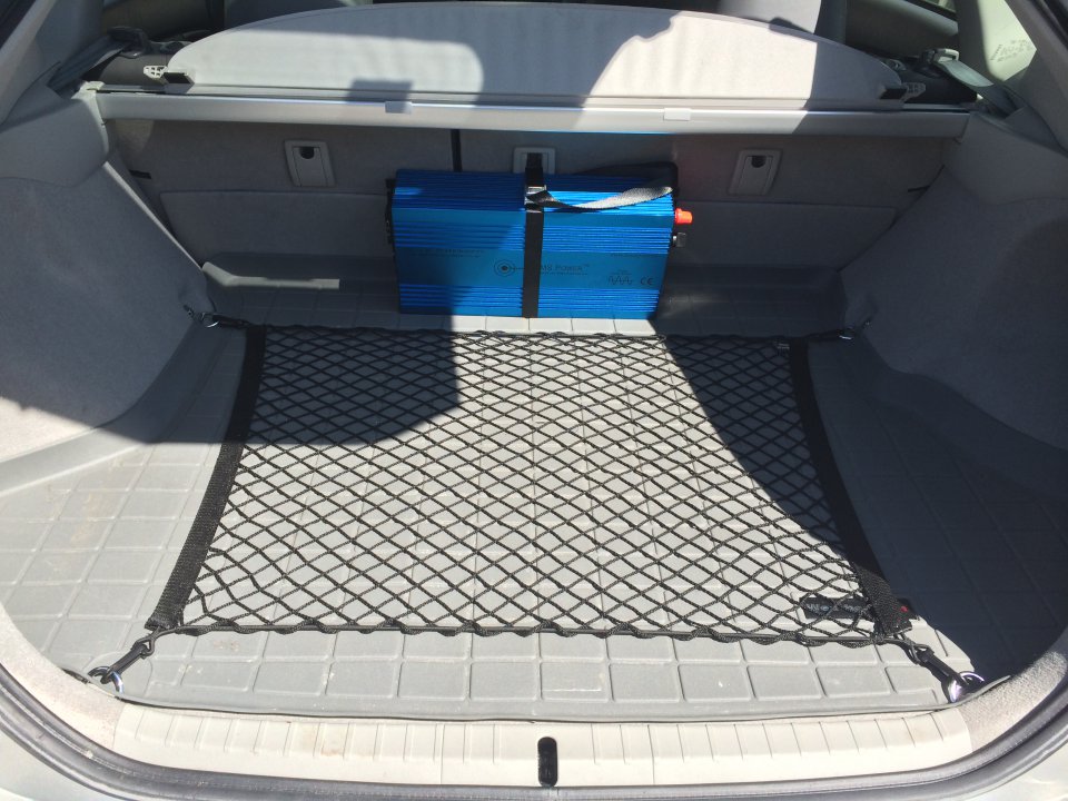

    Started my project and waiting on fuses and plugs.
    I put a piece of heavy foam to tuck away the inverter in the storage area above tire and fits great....surprised me.
    I also noticed the strap that was there for a car seat from Toyota.....works great to mount out of way and usable.
    What do you guys think?
