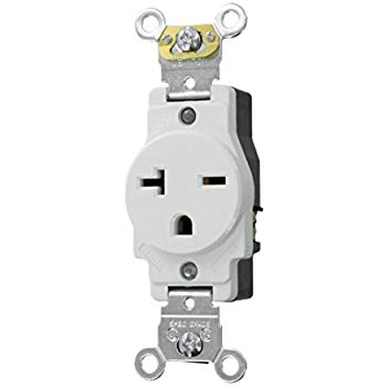

    Yep, installed a NEMA 14-50 and a 50A circuit too for the future. This portable EVSE would a great addition if it had the same NEMA. The NEMA 6-20P on this EVSE is not really popular in the wild, but maybe @bwilson4web has seen it more than I have.

    I would think a 20amp 110vac would make more sense than a 6-20, could potentially fry my outlets, must be a British thing

    The EVSE main plug is a NEMA 6-20P and this is the receptacle for that. Might be just a home bound 240V - 20A connection as I haven't seen that many in the wild. The EVSE then has an adapter cord to plug into a normal 5-15. But the reviews I read said it still puts out 16A even in 110V circuits. That's pretty high for 5-15 plug.

    Not a violation because it probably is grandfathered under older codes and is residential based although new builds and remodeling require 5-20 plugs to indicate you have circuit breakers for 20A (and 12 ga wiring). The 5-20R down supports 5-15 plugs as well because it's possible to have more than 15A with a couple of power hungry appliances like coffee makers, bread makers, toaster ovens, etc.. I know my house has 5-20 plugs for all my 20A circuits when we remodeled to support fridge, dishwasher, garbage disposal, microwave and countertop appliances. Most appliances including even fridges, freezers, heaters, etc. still use the 5-15 plugs and I'm sure they use at least 15A. Even my Dewalt Mitre saw which is rated at 15A, still has a 5-15 Plug and you and I both know you should have a 20A circuit for it. 6-20 typically is reserved for commercial/industrial installations.

    I believe there's a confusion in NEMA outlets/sockets. 6-20 is 220VAC; 5-20 is 110VAC. They look similar. If the right prong is horizontal rather than vertical; it's 220VAC.
