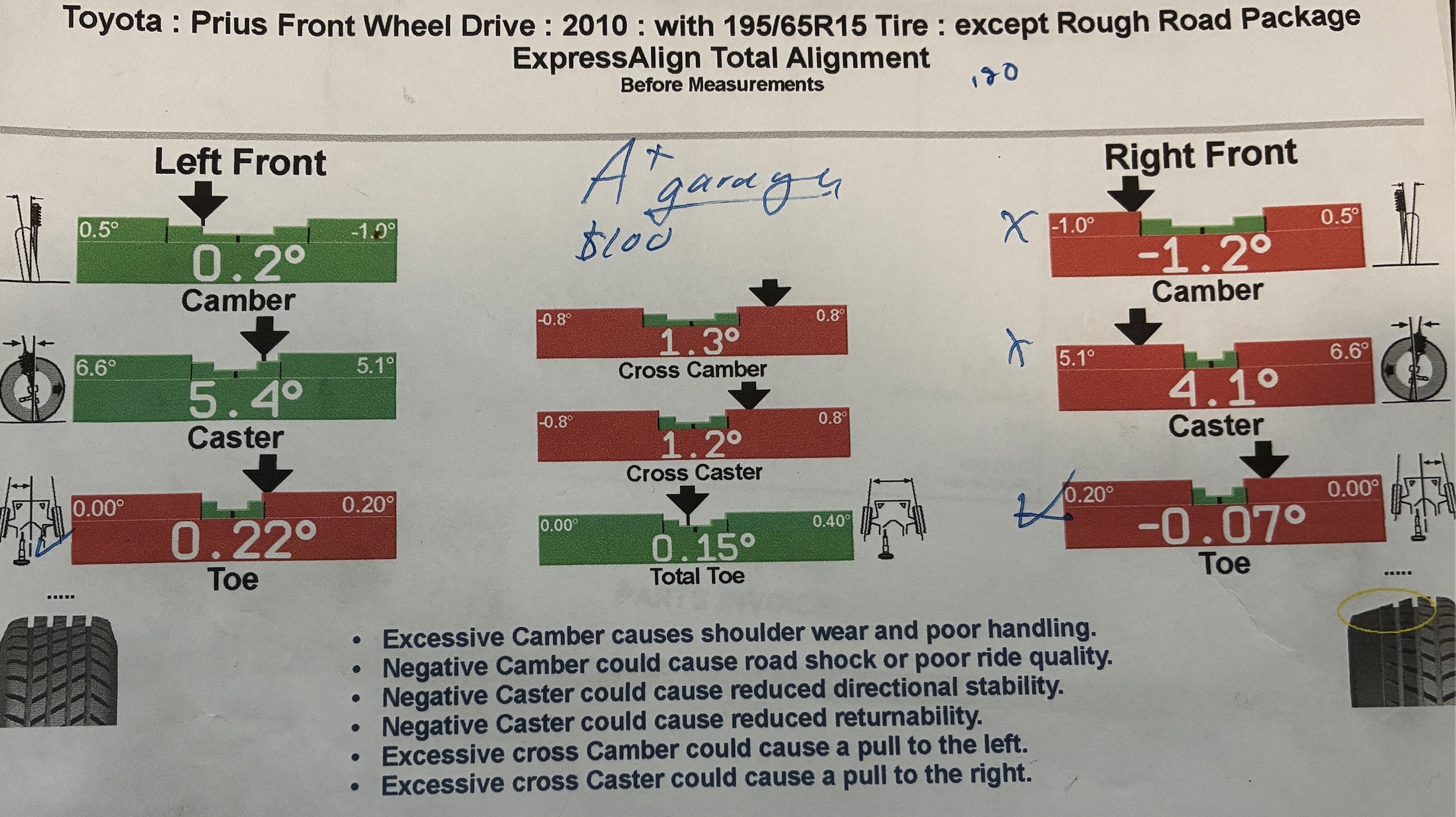

    Google AI indicated that parts are needed to shim up the alignment.
    I would like to have parts "at the ready" for the alignment. If anyone has experience with alignments, what parts does it make to have on-hand given the measurements in the screenshot?

    I believe the Prius has a camber kit that you can use to make it + again, not sure you can adjust the caster, but for the toe, it's adjustable by the tie rod.

    Tombukt2 Senior Member
