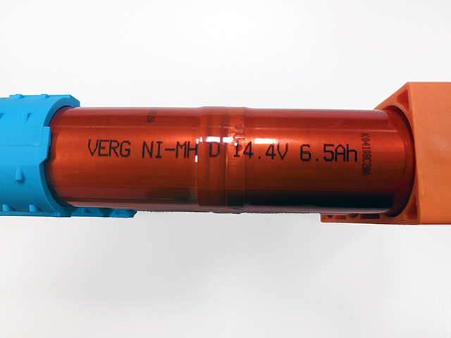

    What do we know about the toaster cells though? Do we have the cell datasheet? Do we know the manufacturer? Do we know about quality control? Do we know how the cells are matched? I've read this thread but not in while so maybe those have already been answered.

    I am expect @2k1Toaster would be willing to share but you may need to PM him. I know he has tested that the cells meet the specifications he requested. He mentioned the specs in a post or 2 here and stated his testing of the CEBA cells proved they were inferior.
    This image from post 1 here gives some information.
    Testing image here. Prius Battery Replacement Kit (GenII/GenIII) with NEW custom cells | Page 3 | PriusChat
    More specs compared to OEM. Prius Battery Replacement Kit (GenII/GenIII) with NEW custom cells | Page 6 | PriusChat

    The cells lasting or not lasting, we've hashed that out. Only time over a large enough sample will be definitive. But as with anything, you can do tests and make pretty realistic guesses. My battery is designed to be as similar to Toyota's battery as possible while adding what I deemed to be improvements. As with many of my business ventures, I want the best for me and if it is not available on the market I make it. Most of my projects nobody ever sees. Some of them, only go to a few people to cover some minimum costs. Others become actual businesses like this one. This isn't my first rodeo.
    My estimations are that these batteries will last an equivalent time to Toyota's batteries. The reason being they are as close to the same chemically as the originals. They are close (more/better) capacity on average than the originals. Under load, they maintain close module balancing just like the original pack.
    The only point of contention I know of, is the design itself being cylindrical or being prismatic. I see and understand what the original designers were wanting to do with the plenum effect. However, I don't think it worked as intended. Remember they were pioneers of this for vehicles. With a perfectly sealed battery and some awesome powerful duct fans it would blow the air through each module nice and evenly. I'm sure that's what the computer simulations of 1998 told them when they made it for the first Gen.
    In reality what we see is the the centre of the pack getting hot, suggesting uneven airflow. In a true plenum style design, this wouldn't happen, it should heat evenly. Also with the tight spacing the entire pack heats up more slowly acting as a heat sink but that also means that the pack gets heat soaked for longer times before the fans kicks in. Both of these tell me that the design isn't working as intended. BUT, it is working sufficiently well that Toyota deemed it unnecessary to go back to the drawing board.
