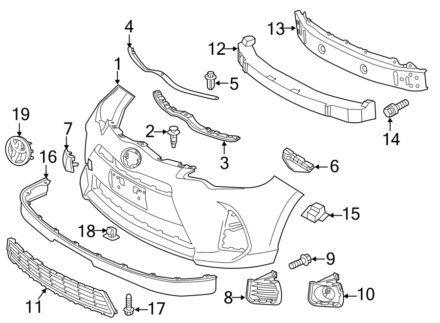

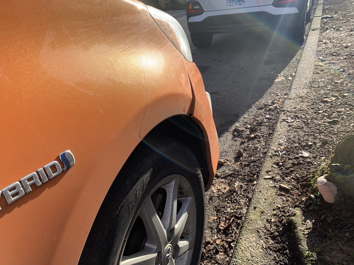

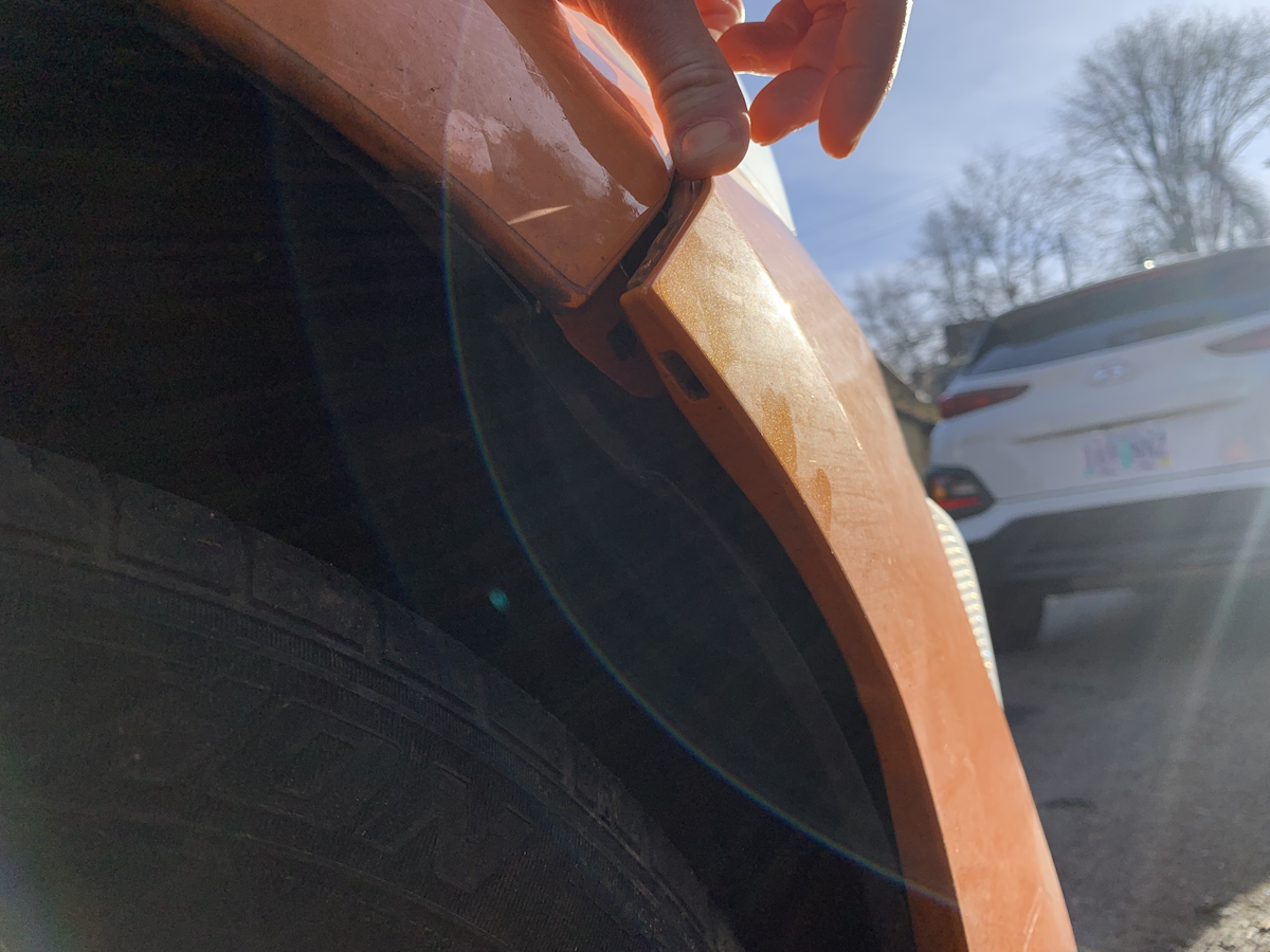

    I'll resuscitate this thread, since i have a similar issue. I've been struggling to identify the part number for this clip, which is clearly missing. I found this diagram for the front bumper on lakelandtoyota, but it's not very clear what's what.
    Would appreciate the help tracking down the part! Thanks!

    I believe the part your looking for is #6, in your diagram. Do a very close inspection of the edges of part #1. If the lock points are not intact, ripped out; replacing part #6 won't do you any good.
    I removed part #1 on my old 2012 Prius C, to push out a dent - those lock-tabs are pretty brittle. Try just pushing it back in, to see if it'll locks back into place.
    Good Luck...
