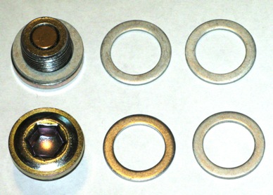

    Hi all,
    I plan on doing my drain/fill soon although I had several questions:
    - Is it necessary to change the bolt/washers ? If so..
    - Does anyone have the OEM part numbers for the bolts/washers ?
    Thanks !
  8. Mendel Leisk
    60,286
    41,478
    You should change the washers. Assuming you're getting Toyota ATF-WS transaxle fluid at a Toyota parts department, you shouldn't have to tell them washer part numbers, just "transaxle drain/fill bolt washers" and the car model will do.

    506
    Neb
    If I recall from our 2009 Prius trans, the washer was solid and thick aluminum. No need to change it at all...just torque it back down.

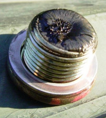

    Unfortunately, Toyota eliminate d the magnet on the plug on ALL Gen III's that were present in ALL Gen II's.
    Even the small ceramic magnet caught a lot of steel and iron worn off the gears and other parts.
    I'm just NOT allowed to sell the kit through PriusChat.
    Given the very long change intervals, a magnet is a good idea.
    When I changed my transaxle fluid, I added an ultra strong N50 neodymium magnetic drain plug that a fitted to a machine milled out OE plug that I got from my Toyota dealer.
    I didn't like what was available anywhere, so I made my own.
    Nice thing is that it is an OE plug. So, it uses the same 10mm hex key socket.

    Reposting that transaxle drain and fill bolt washer info, lost in yesterday's shake-up:
    Part number: 90430-18008
    Description: GASKET
    Note, this is for the regular Prius, maybe the same.
    Again, if there's a dealership nearby, it's real easy to just pick everything up there, and a generic description of the washer will do, it's up to them to chase down the proper washer.
    As to reusing the washer, not changing it: sure, it'll likely be fine. But this is something you do maybe every 3 years? Saving $1 or two by reusing a washer??

    The Prius"c" uses the SAME washer.
