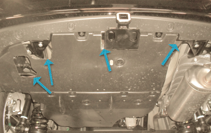

    The EcoHitch for the 2010+ Prius does require minimal cutting into the car's plastic cover, this allows the hitch to be completely hidden behind the bumper - maximizing ground clearance. This picture shows the small cut points that are made during installation.

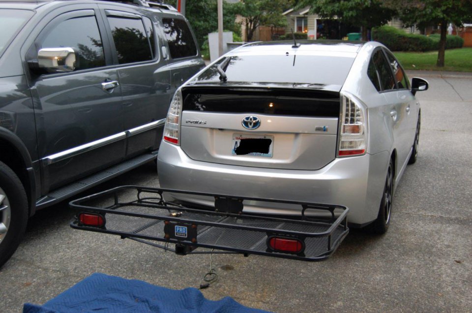

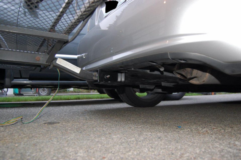

    Sorry, I was traveling and didn't see this thread until now.
    Yes, I have this hitch. It was installed too soon to get any precise before/after MPG comparison, so I don't know if the raw hitch produces any loss. If it does, it is small.
    But the rack and bikes, not surprisingly, do produce a substantial MPG hit. Percentage-wise, I think the loss is about the same as the roof racks on my two previous cars, about 15%. But because the baseline fuel consumption of this car is much less, so is the absolute fuel cost of this hitch-mount bike carrying arrangement.
    With the car unloaded, my hitch has 10 inches of ground clearance. I'll be shocked if it ever drags on anything.

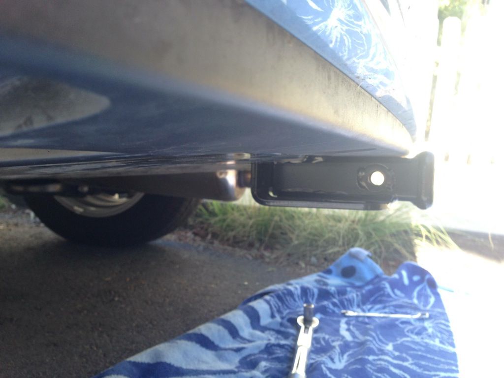

    Sorry for bringing up an old thread. I just installed an ecohitch on my car and while the finished product looks great, I was very disappointed in the installation process and instructions. Maybe it's just because my car is the Plug-In version. Since this is one of the threads that convinced me to get an ecohitch I'll post my experience here.
    1. The installation instructions read like the person writing them hasn't actually done the installation. There were typos, unclear descriptions, and the fastener size call-outs were wrong. The instructions specified to cut way more of the plastic than is necessary.
    2. I DID have to trim some sheetmetal to get mine (new version, ordered 9/4/2014) to fit.

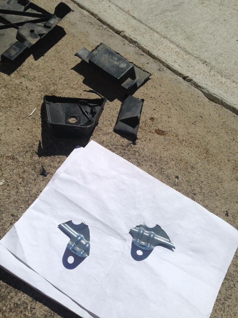

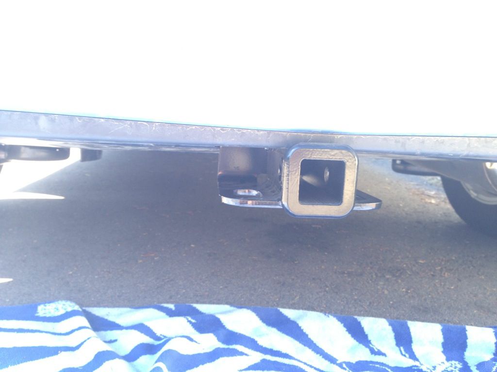

    I just installed one on my 2010 last night and didn't cut those tabs off that you did. I agree that the instructions aren't very clear on where to cut the plastic except for the 6 x 3-3/4" rectangle around the receiver but I was able to eyeball it and mark where to cut with a sharpie. I used a sharp box knife and electrician scissors to cut the plastic. I couldn't get a lot of the plastic fasteners to go back in the holes in the bumper cover because they are too long and hit the hitch. I also broke almost all of the fasteners that connect the rear plastic cover to the one further forward.
    Glad I was wearing eye protection because when that underbody cover came off I got a face full of dirt and gravel!
