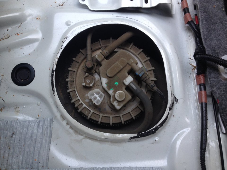

    Hi! i'm from brazil and recently went to replace the fuel filter of my 2013 prius. when i went to assemble everything again i had problems screwing on the pump cover. it seems to be ovalized because it does not thread correctly. has anyone been through this and has any solution? I have a gas leak over there

    But looking at it and "assuming," you have not messed up the threads? I would clean up all the dirt. Then pull off all the connections and with those out of the way, try and screw it down straight and sung, and then reconnect everything.

    According to this thread, that large threaded ring with gasket needed to be replaced when the fuel filter/pump was changed.
    Changing a GenIII Fuel Filter | PriusChat
    The Toyota part number is 77169-52040

    Practice and as many attempts as needed until it threads on correctly- it just "feels" easier when it's started correctly. Definitely clean every bit of dirt out of the plastic threads on the ring and on the tank. Been doing these for years and it still can take me several tries.

    Certainly could not hurt to change it out but it strikes me as overkill? I have deal with that setup on a few car's. And kept the original parts and never had an issue. But sure it could not hurt to change it those parts out. :)
