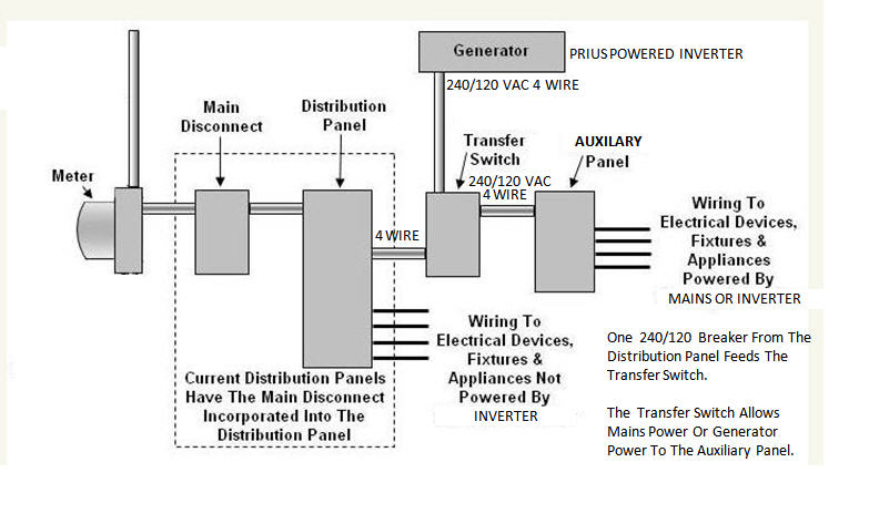

    Interesting start. I would recommend contacting the inverter manufacturer directly and let them work through the steps with you. Then you would be in a better position to attempt a DIY or better yet, find an electrician to do it for you. By the way, electricians would not normally have experience or training on how to install an inverter to a Prius.
    I would offer the following:
    1. The issue of 3 wire versus 4 wire to the transfer switch is because you are looking at a 120 vac only inverter (hot, neutral, ground) and connecting to a 240/120 volt transfer switch, auxiliary breaker panel and main panel which requires two hots for 240 volts, a neutral and ground (a 4 wire circuit). If it were me I would buy one of the 240/120 vac inverters (at least 3kw) which has a 4 wire output connector.
    2. When using a transfer switch and an auxiliary panel (see pic), the breakers in it normally replace the corresponding breakers in the main panel. So the house wiring to those breakers has to be rerouted or extended to the new auxiliary panel. This approach means there is only one switch to power up all auxiliary circuits and could be simpler for a wife or anyone who does not know much about the circuit breakers. It can even be automatic or have a remote switch in some cases. This is how a system might be wired in an optimum situation and eliminates splices in the main panel. PRIUS INVERTER.jpg
    The less expensive approach maintains the primary breakers in the existing panel and simply adds one transfer switch/breaker panel. Those are the $300 options on ebay. The existing critical breakers have their load hot wire disconnected and wire nutted to a wire from the transfer switch/breaker panel. Another wire from the transfer panel is connected to the old breaker. This process is repeated for each critical load breaker. When utility power is lost, individual transfer panel breakers are switched to the inverter/generator output, which is usually plugged into or hard wired into the transfer panel. There are several videos on youtube for this kind of install including this:
    3. To add appropriate detail to your step by step, add model numbers or generic types to all of the parts like the inverter, transfer switch, etc. In electrical work, a drawing is often essential to properly understand the connections and wire sizes.
    4. The cheap inverters are usually for 12 vdc inputs and will fail quickly. Some of the solar inverters allow 48vdc. The power electronics in these are weak. You are talking about using the 201 vdc Prius battery.
    5. Finally, your comment about an industrial UPS: It would still have to take the Prius HV DC voltage and invert (convert) it to AC at the proper frequency. 240 vac household power is actually 340 volts to each sine wave peak from ground, and 680 volts from positive to negative sine wave peak. So any 240 vac inverter has to convert/invert the input DC up to 680 peak to peak or half that (340v p/p) for a 120 vac only circuit. Also, when an inverter specs say "pure sine wave" it means the best quality smooth sine wave and not a stair-stepped cheap representation which can cause trouble to motors and some electronics.

    Does your system use a 12v, 24v or 48v inverter? A 3000w or 5000w, SP, LF, 220v/110v. In other what are your inverter and Transfer switch specifications.
    Thanks for the comments/suggestions. I thought I would go with either a 3000w or 5000w pure sine wave, LF, 220v/110v (240/120) inverter. I have read that the Prius HV battery and system outputs a max of 3000w so I am leaning toward 3000w with a max of 9000-12000w. 5000w seems excessive. I am undecided on 3000 vs, 5000, and 12v Vs 24 or 48. So your 48v comment is appreciated. I know the HV battery output 210-235vdc but thought that since it is connected to a 12v battery 12v would be appropriate.
    The transfer switch I am considering is a Generac Power Systems Portable Generator # 6294 Transfer Switch Kit Includes : 30A Prewired Transfer Switch, 30A Non-Metallic Power Inlet Box, a 4 wire, 10' Power Cord With L14, 30 Ends and Accommodates 6 To 10 Circuit breakers. See my original thread for installation. I am planning on consulting with an electrician before I finalize my system and having them do the critical wiring.

  10. rjparker
    rjparker Tu Humilde Sirviente
    Jun 6, 2008
    10,971
    6,881
    Texas Hill Country
    First, I think you should draw a simple diagram and include in your #1 post. Second, you should
    edit #1 and erase everything in the #6 post. Install step 6 says you are connecting to the HV battery which is not the 12v battery. If you are going to attach to the 12 volt battery you don't need to mess with the HV battery.
    However you should limit a 12v inverter from a small Prius 12v battery to about 1kw. First you are really running off a small portion of the engine's dc to dc converter. Second, 1kw of power from a 13.5v battery is 75 amps. -3kw from the same 13.5v battery would require 225 amps! Obtaining 3kw from the HV battery is 15 amps and does not go through the engine's dc to dc converter. But the Prius won't give you more than 1kw (1000 watts) through the dc/dc section, so running a 3kw 12v inverter on the Prius won't work.
    Assuming you want more power (which you really need to power a house's critical loads like a furnace, refrigerator, lights, etc), then you hookup directly to the HV 201 vdc battery. That is the advantage of the ConVerdant inverter, they are made to accept a Prius' 201 vdc source directly and are able to provide 3kw or 5kw pure sine wave. Hooking up any ebay inverter to the Prius HV battery would not work and would probably burn something up.
    If you go HV, I would go with a 5kw as that gives you 20 amps at 240/120 vac which is not much if you are talking about feeding a 6 breaker panel. A 3kw gives you 12.5 amps at 240/120 vac. By the time you consider what the critical loads are, you will want as much as possible.
    Here is a link to a 12 vdc install with a 1kw inverter. --Running an Inverter off a Prius for Backup Power | Peak Prosperity -- His refrigerator would not run off it but he did not need to access the HV 201vdc battery.
    In the following link, a 12 vdc 1kw inverter was monitored for power used. -- Prius - UPS Project -- In his testing he found the Prius controls would limit it's 13.5 volt output to no more than 1kw by reducing the 12v battery voltage, effectively discharging the battery.
    This last link, - Prius as Back-up Power | PriusChat-- from this forum has an excellent pdf in the first post of a 1kv inverter install.
    Finally, working with the HV battery is really dangerous with possible life threatening injuries.
    #10 rjparker, Feb 12, 2015

  12. Jdollhausen
    Jdollhausen New Member
    Jan 29, 2015
    I have read almost every thread on the use of a Prius as a generator and have published a initial procedure for review. I have received great feedback from rjparker. I have seen a procedure for using the HV battery, an inverter, a transfer switch/inlet box, L14-30 power cord and main breaker panel. What I derive from all threads is this can only be done using the Converdant Vehicles system. That is because the HV Prius battery is 220v so you need a 220vdc or larger (PSW, LF, SP 220vac/110vac) inverter. I am inquiring if Converdant even uses a Transfer switch and what vdc their inverter is. I have checked their site and list of specifications but found no reference to these elements. I also can’t find much on how to wire an inverter to a transfer switch or inlet box.
    Using the 12v battery won’t work for me. We live in an all electric condo. I have decided to isolate most of our baseboard heating elements. from the backup system because they use from 500 to 2000 watts.
    Does anyone have any details regarding how to wire an inverter to a transfer switch- plugs, vs. hard wiring, three vs four wires and what VDC inverter to use.
  13. rjparker
    Jun 6, 2008
    10,971
    6,881
    Texas Hill Country
    Call Converdant and they will give you details on their 3-5kva AC outputs, both the 4 wire plug and hardwire options included on every inverter. Call an electrician to get quotes on installing the transfer switch. Converdant does not supply the transfer switch and their website indicates it will accept your 201vdc input.
    I have updated my post #7 above to reflect your $300 transfer panel idea versus a separate transfer switch feeding an auxiliary panel.
    Before I would buy anything, I would have an electrician actually measure the amp draw of your base board heaters and any other loads you are considering with the loads fully running. Simply using existing breaker sizes will likely overstate amp requirements. I would also check with your condo management and ensure they are good with running cars in a garage and modifications to the condo's wiring.
    #13 rjparker, Feb 18, 2015

  14. Jdollhausen
    Jan 29, 2015
    What I derive from all threads on this topic is this can only be done using the ConVerdant Vehicles system kit. That is because the HV Prius battery is 220v so you need a 220vdc or larger (PSW, LF, SP 220vac/110vac) inverter. I am inquiring through email about the vdc of ConVerdant’s inverter. I have checked their site and list of specifications but found no reference to these elements. I haven’t received a response from them yet.
    ConVerdant, seems to have a monopoly on the inverters that can be used for this purpose and they're charging $2,000 for a 5 kW inverter. Once you add the cost of the transfer switch and installation you're up around $3,000 to maybe $4,000 for the system. Given the fact that our area hasn’t experienced any long power outages yet I am in a quandary as to whether not to spend that much money on basically an insurance program.
    Since I will have an electrician wire the transfer switch to the main panel that is not issue.
    Does anyone have any details regarding how to wire an inverter to a transfer switch/inlet box- plugs, vs. hard wiring, three vs. four wires and what VDC inverter to use. That being said, I am looking for an inverter that will work for under $1000.
    Regarding my heating elements. Each one has a label on it that gives the wattage. They range from 500 watts to 2000 watts The living room circuit has 4000 watts, What I plan on doing is installing switches on all the units and switching the larger ones off.
    Otherwise I will use space heaters which have a draw a maximum of 1500 watts. I also have a indoor safe LP gas heater that will heat up to 1500 square feet. Therefore using the Prius generator to generate heat is not a big issue.
  15. Jdollhausen
    Jan 29, 2015
    I have discovered an alternative to the transfer switch kit when using any back up generator that is:
    a Generator interlock kit costing around $60-$70 as opposed to $300.
    (Wikipedia)
    A generator interlock kit (or just interlock kit) is a device designed to allow safe backfeeding of a home through a portable generator during power outages, thereby eliminating illegal and/or unsafe generator backfeeding situations that could potentially electrocute power linemen or destroy the generator.[1]
    Operation
    A generator interlock kit is installed on the front cover of the home's breaker panel. It consists of two sliding steel or plastic (depending on the brand) plates held together by three bolts. When moved down, the plate blocks the generator backfeed circuit breaker and allows the main breaker to remain on; when moved up, the generator backfeed circuit breaker may be turned on, but the main circuit breaker is blocked and will remain off. The generator backfeed circuit breaker is connected to a generator inlet installed (preferably) on the outside of the structure. A short cord connects the generator to the house inlet, usually through the use of L14-30 twist lock plugs and sockets. Determine the manufacturer of your main panel and purchase that companies interlock kit.
    Advantages
    • Using an interlock kit allows for all of a panel's circuits to be energized, up to the load capacity of the generator; whereas using a generator transfer switch only allows a few circuits to be operated.[2]
    • An interlock kit does not require a separate panel to operate; it can be installed directly on the home's breaker panel.
    • only allow the the generator breaker to be switched on if the main breaker is off
    • not allow the main breaker to be turned on unless the generator breaker is off
    Kits include top and bottom interlock plates, hardware, warning stickers, generator operation instructions, drill bit, and installation instructions.
  16. Randy B
    Randy B Member
    Jan 2, 2012
    104
    30
    NH
    This is ConVerdant - Randy Bryan
    Good thoughts and investigation. I have some thoughts.
    The 3 and 5 kva inverters [actually 2.4 and 4kw] have 3 AC connection points on the back; a 4-stud power strip [for a customer cable], 2 standard 120v 3-prong sockets [circuit A and B] [recommended only for extension cord connections], and a round 4-prong twist lock 30A socket [for a standard Generator cable].
    There are two ways to hook up a Prius to the transfer-switch/subpanel; 1. with the inverter next to the car [in garage] where the AC out of the inverter will be connected using a standard generator cable to a standard Generator socket mounted in the garage or on the side of the house, which is cabled to the transfer switch and subpanel in the garage or basement. This is the same set up used for any mechanical generator. 2. with the inverter in the basement where an extra long custom cable brings the Prius 202v DC power from the car to the inverter in the basement. Then the inverter can be hard wired to the transfer switch or a short standard generator cable can be used if both devices have the 4-prong 30a twistlock sockets. This second way provides better protection for the inverter, which doesn't like exposure to sun or freezing or moisture/frost.
    Also, know that the Prius can only supply a max of 3kw continuous power so even the 5kva/4kw Plug-Out cannot be run at max power. In fact, it was added to the lineup to handle startup surge requirement of various appliances [with motors] that can be quite large compared to the continuous power specification.
    Also, note that one should never try to load the inverter to its maximum power spec.. You get too close to tripping the overload protections and end up with an unreliable power source. Try 2/3 to 3/4 the load spec a your goal [1/2 power for mechanical generators].
  17. ChapmanF
    28,608
    18,943
    Hello @Randy B ! I was just thinking of asking you guys what ever became of the little blue fifteen-pound, 2kw inverter you used to list (right up to the month before I bought my Gen 3!). It seems gone from your web site now, is it gone for good?
    -Chap
