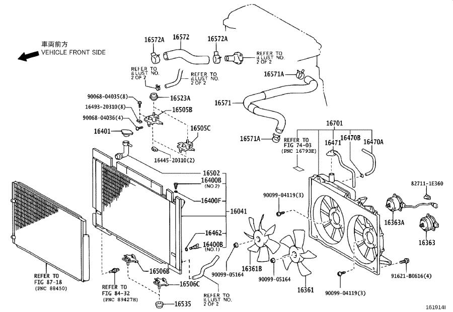

    I need to replace the engine coolant reservoir, NOT the inverter reservoir. I’m having a terrible time finding the right part. Car is a 2008 Prius.
    can someone give me the part number? When I do a search I keep getting one for the inverter system. Thanks!
  7. ChapmanF
    28,691
    18,996
    Toyota doesn't seem to sell that bottle separately from the cooling fan shroud, callout 16701 below, part number 16711-21100.
    Salvage yard?
