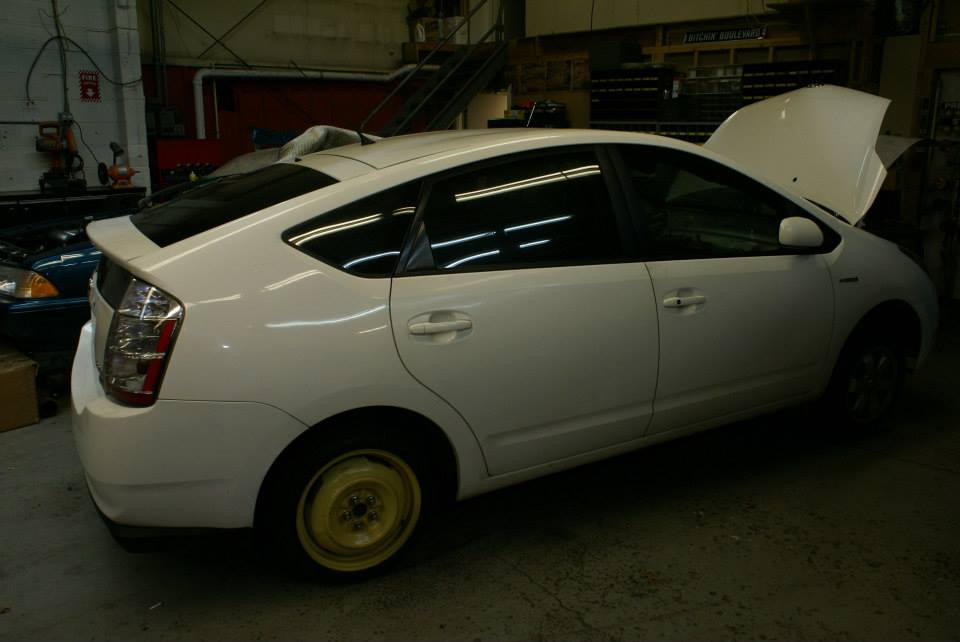

  5. mrstop
    mrstop PWR Mode
    Jun 22, 2012
    740
    329
    109
    Cincinnati, OH
  6. JimboPalmer
    Apr 14, 2009
    12,470
    6,878
    Greenwood MS USA
    Is it just me or is he sending V8 power to a spacesaver spare tire? [​IMG] Looks like a fiberglass Prius body over a chassis that worked would have been better.
  7. mrstop
    mrstop PWR Mode
    Jun 22, 2012
    740
    329
    109
    Cincinnati, OH
    He has tubed out the rear, widened the factory wheels and installed a ladder bar suspension. If you can get by the Prius hate, it's an interesting build.
