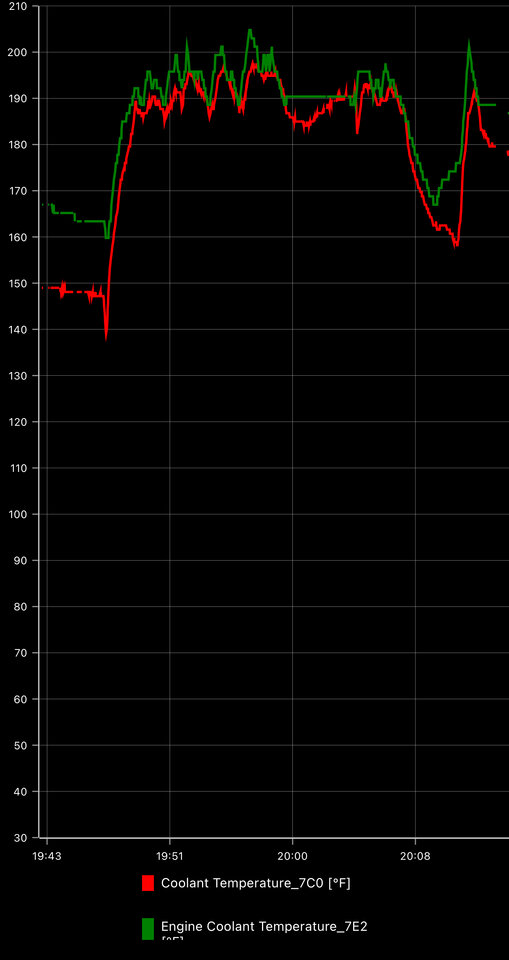

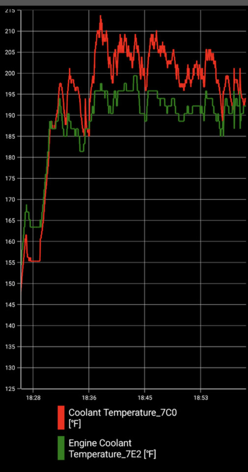

    206f on a steep hill in hot weather is ok. But you said 206+. Does that mean 240f or higher? Typically the light comes on at 248f.

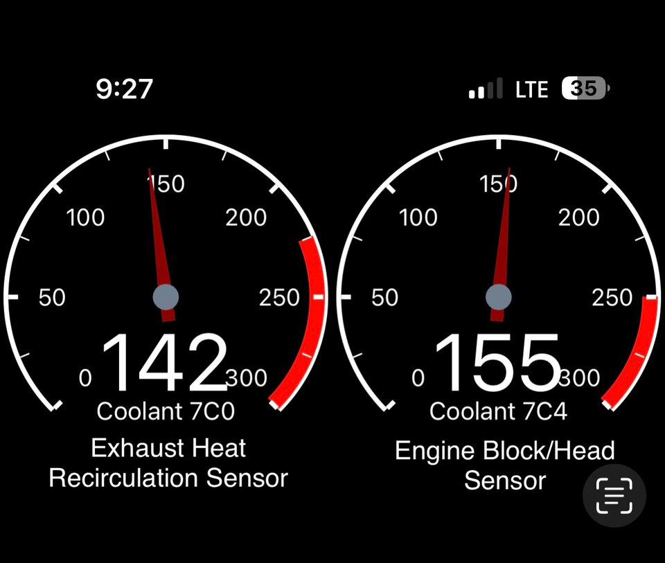

    Gen3 has two engine-coolant temperature sensors to monitor and either one can flash the light. One is on the engine while the other is on the hose coming from the exhaust heat recirc system. With Techstream one is in the ecm pids while the other is in the Combination Meter group. Both are called Coolant Temps.
    As noted in a July 14th post, the exhaust recirc thermostat could be stuck in the heat exchanger position adding unnecessary heat after warmup. This was reported at least twice now. The engine temp could be fine but the exhaust heat exchanger sensor (Combination Meter ecu) could trigger the light.
    I use the Car Scanner app to display both engine-coolant temps.
    Normal capture of both temps (Exhaust Heat Coolant Temp in Red)
    Overheat light caused by a stuck exhaust heat recirc valve. (Exhaust Heat Coolant Temp in Red)
    In the above Car Scanner capture the red trend exceeds the other sensor but not enough to trip the warning light in this test run. However the owner MSB87 replaced parts of the exhaust heat recirc system and eliminated the problem.

    You still have not mentioned exactly how hot it gets. Are there any codes? For the light to go on requires higher than 206f.
    Has the coolant been low requiring topping off?
    If there is air in the system it typically accumulates in the reservoir and is released. A gen3 normally does not trap coolant in heater lines where it might be heard "bubbling" in the cabin.
    However if there is a head gasket leak again (not unheard of) then combustion gasses may continuously inject into the coolant.
    The temperature light is concerning and could be caused by low capacity due to previous sealer clogging the radiator, low coolant, weak water pump, or a bad thermostat.
    If it is losing coolant that is not a good sign. Regardless I would get a monitor capable of displaying both coolant temperatures and see what is happening. Both should closely track each other. Low cooling system capacity may show higher than normal temperatures without a steep hill climb.

    It's possible you are hearing the brake pump operate.
    If the temperature light comes on again you need to monitor both coolant sensors.
