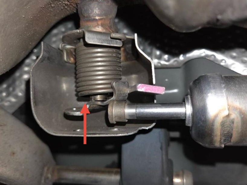

    So the valve moved freely but the actuator was seized?
    Did the valve move easy enough that exhaust pressure would have opened it per the manual?
    Was the coolant hot when you tried to move the actuator?
    I wonder if there is room for a screw coming up similar to this?

    The valve seemed stuck at first, it took a bit of effort to get it to move. Then it did loosen up after working it back and forth many times.
    The coolant was cold at the time I worked on it. It's been hot and humid here, I didn't want to work in tight quarters underneath a hot exhaust system as well.
    No, I don't believe that exhaust pressure would be able to overcome the resistance of that heavy spring holding the valve in the default closed position.
    I don't think a screw or bolt through that hole you indicated would be able to hold the valve open, even if I put a rivet nut in the hole to bolster it, I don't think there's enough clearance for a rivet nut anyway.
    I have the valve jammed open quite well I think. That spring creates a lot of tension against the piece I jammed in there.

    I didn't leave the pliers on the assembly. I just took a picture to show how I gained leverage on the spring loaded valve assembly with the pliers to open it and wedge the aluminum bar stock to hold the valve open.

    The aluminum bar does not interfere with the actuator rod at all, I made sure there is no contact.
