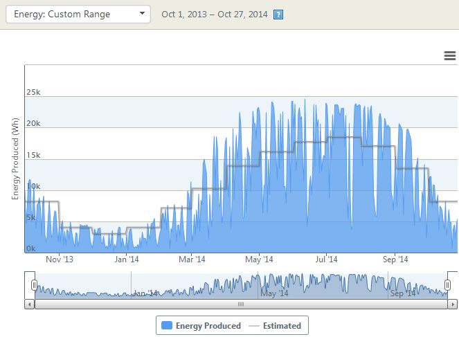

    How much seasonal difference in daily production do you expect, at your likely location?
    For my location and weather (i.e. typical interference, based on local recording stations), NREL's PVWATTS calculator (an old one, not the updated version posted now) expected a 6 to 1 ratio between July and December. NREL's monthly average is the gray stepped line on this chart, superimposed on my daily production chart (courtesy of Enphase's online monitoring tools):
    My all-electric house also has a very strong seasonal demand curve, nearly 180 degrees out of phase with this production pattern. Because of that, off-grid won't work for me. If sized for yearly annual production and load, production would be drastically short in winter, while the large summer excess couldn't be sold to the local utility or others to help defray its original cost (or collect the state incentives). So I need the on-grid net metering to make things average out over the seasons.
    Your CO-NM location should have a less drastic seasonal production variation. And a passivHaus with combustion backup should have less load variation than my house. But I'm guessing that the mismatch will still be significant.

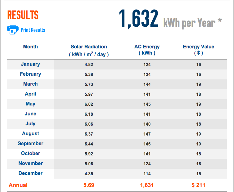

    My NM house had a doubling of electric consumption in deep winter compared to light months (240 vs 120), but I'm pretty sure all of the increase was from AC: The heat was NG combustion, but air through the whole house ducting consumed 1 kW of electricity. A PassivHaus has a baseload ventilation demand that is amenable to folding into the PV generation with a small battery storage.
    As you say, this geography lends itself really well to PV (and passive solar, for that matter.) Below is a PVWATTS estimate of daily insolation of a 1 kW panel oriented at 50 degrees:

    ^^ I'm jealous. Only a 22% reduction in expected energy production at the depth of winter, compared to the 84% reduction expected at my house, and 89% reduction actually observed (PVWatts doesn't know about neighboring trees). Having always lived in cloudy portions of the PNW, it is easy to forget that some other areas get excellent winter sun.
