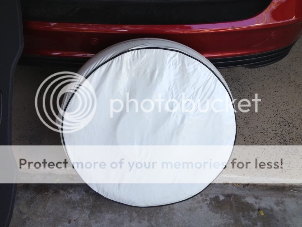

    I got a mini-spare for long trips in my CMax. It will stay in the garage for daily, local driving. Anyway, I found a good (re: cheeeeep) cover for it: http://www.amazon.co...0?ie=UTF8&psc=1
    $10 shipped.

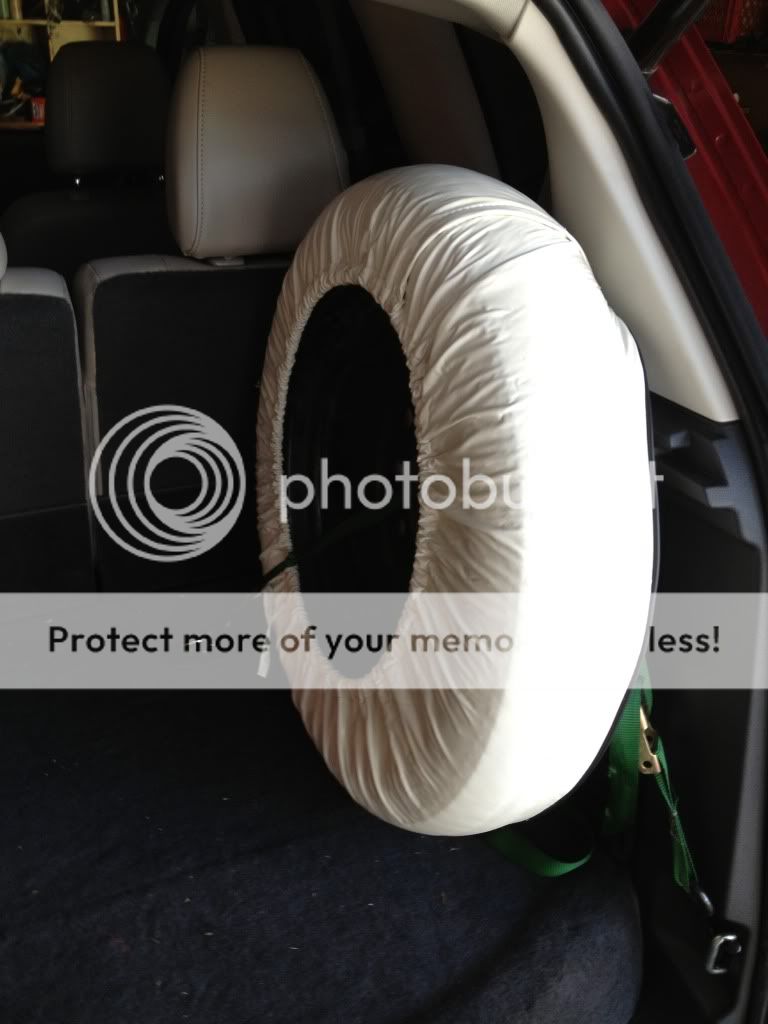

    Strapped in:

    fotomoto, I like both the cover and the standing spare idea you used. Mine is centered in the cargo area, lying flat and secured with the tie down strap supplied by Toyota. I think I will try it your way and see if it makes it a little easier to load groceries and sometimes plants and other nursery stuff. That's about all I put back there, since we don't take long trips in the PiP. I keep the spare there all the time however.
