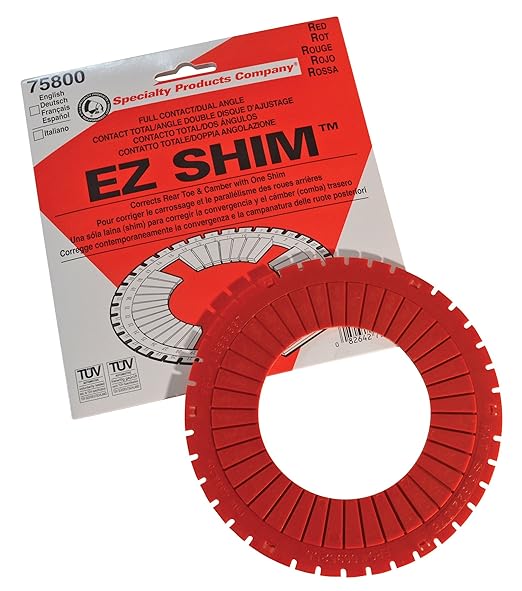

    I prefer to take measurements and then adjust. Speculating on another car is not a good idea. But let me share how I took these measurements:
    That is an IR thermometer mounted on a piece of shirt cardboard affixed to the three legs of a small tripod. The tripod holds an iPhone that is focused on the temperature display. That IR thermometer is put in continuous reading mode.
    I drive the car ~10 miles at high speed and pull off the highway onto a parking lot. I then make a movie showing the tire tread temperature for each of the five treads. In my case, I did two passes on the passenger side and then two passes on the driver side.
    IMHO, Toyota and BMW have too much negative camber on the tires. Worse, I can not depend on the service departments to change it to what I want. So I'll do it myself.
    There are two approaches: (1) metal tabs, and (2) Specialty Products shim-disk. I used both on our 2003 Prius and found the metal tabs are much easier to install and can fix camber on one side and toe on the other. The Specialty Products shim-disk can handle both camber and toe on a wheel-by-wheel basis.
    My thinking is to do the tabs for now. I live in an area with little snow and salted roads. Since I tried both, I'll probably go with the metal tabs for now.
    One problem is I can't buy a life-time alignment from Firestone, yet. I haven't check Goodyear. However, it looks like I may be able to do my own camber and toe measurements. If I go with self-measurement, it will be a lot easier to measure and adjust.

  17. bwilson4web
    29,102
    16,537
    Gen 1 too and I used shims to adjust the rear toe and camber. But I used Firestone's "lifetime alignment" service to check what I'd done.
    Specialty Products makes a nice one:
    I started with metal tabs but later switched to these. I had occasion to take one off later hoping it had reduced the risk of rust only it didn't appear to work that way. I didn't have a rust problem, Alabama hasn't had salted roads but maybe twice in the past 10 years. So I'm planning to just use metal tabs.
