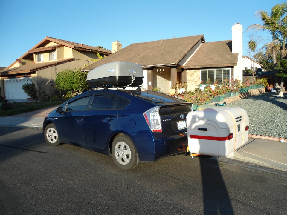

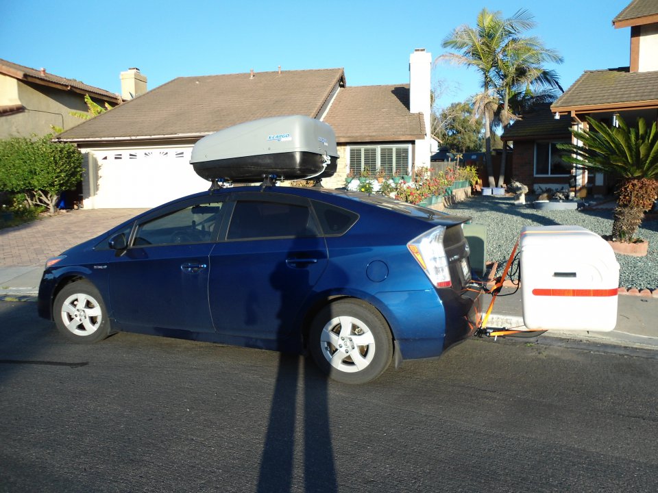

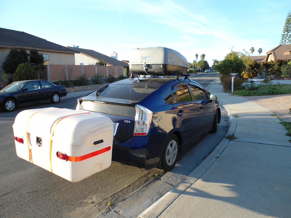

    maybe pull the trailer, which I will not do that like Engerysave, but I do carry Stoway box which is 16 cubic feet and it really put the back the car LOW, that why I need it, by the way, why not stress out HSD? saving gas and testing the new thing :)
