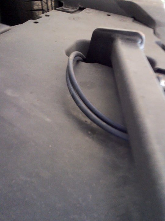

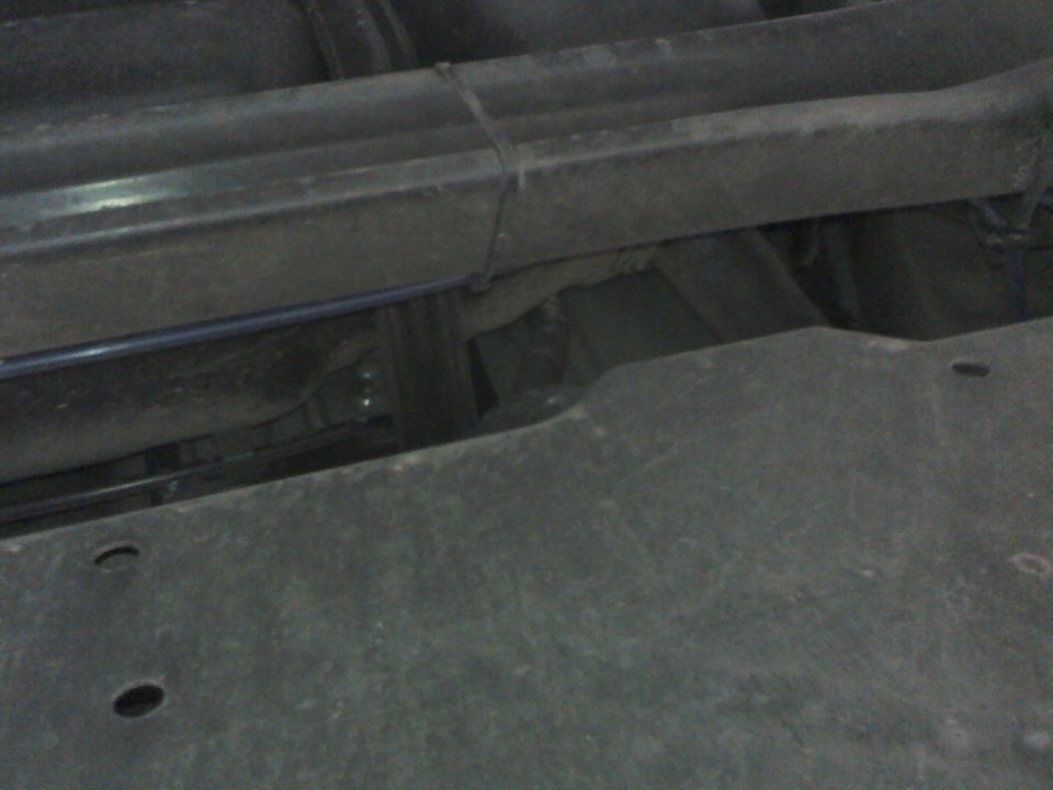

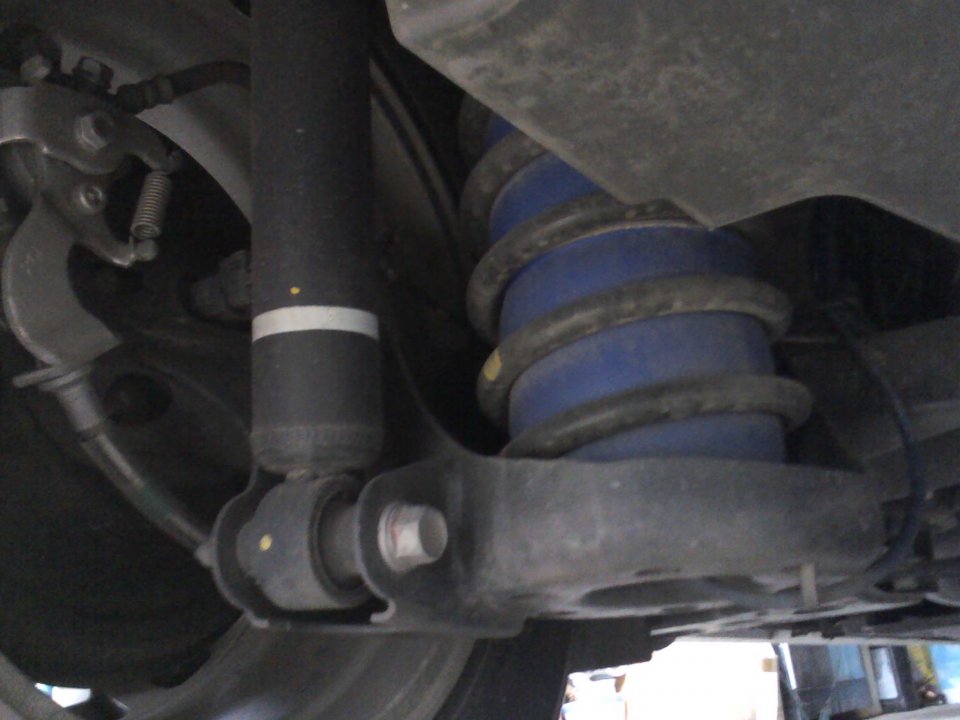

    Getting my C ready for safe towing and about to install my Ride Rite springs. I noticed you have your air hose pointing down throw the spring perch? Did you also install the lower supports as well?
  17. engerysaver
    engerysaver Real Senior Member
    Nov 26, 2011
    426
    133
    Tyler, Texas ; USA
    I did not want to pinch the air hose ....... I used plastic ties on the OM supports.:)
  18. priusCpilot
    priusCpilot Active Member
    Mar 6, 2012
    663
    210
    LA
    I did the install and it went great. I was able to keep all the lines stealth. I routed them threw a frame hole and went to a T fitting which files both at once.

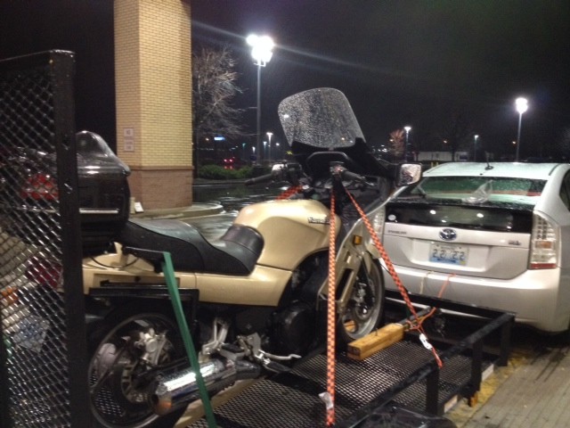

    Just wanted to add this to the thread. I have a 2010 gen III that I bought in May of 2009. I have been towing almost since I purchased it. I bought the curt hitch. My trailer is a 5x8 utility trailer. My 2010 now has 176,000 miles on it an runs like a top. I have had to do two repairs to it. Replaced a front headlight at about 100,ooo miles and a rear wheel bearing at about 175,000 miles. I use the utility trailer for local hauling and long trips.
    I have a scanguage II that I monitor WT RPM SOC and LP. With this load it handles perfectly and drives without issues.
    Here is a pic.
