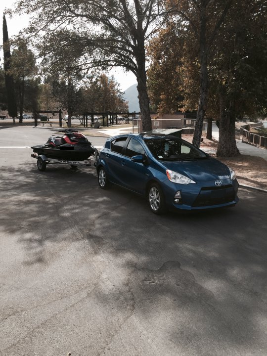

    Yes I final did a tow with my C!
    Est 1100lbs aluminum trailer and PWC.
    Climbed to 2700 feet elevation.
    I used a Eco Hitch from Torklift which was the highest quality hitch for the C. Really well built here in the USA with the best fit and finish!
    Curt PIP Prius V wiring harness which I re soldering the wiring to be correct to work with the C. The plugs are the same from the V but not the liftback.
    Firestone Ride-Rite airbags which really made thing safe and smooth.
    I monitored 4 vital perimeters with the SG
    HV Batter temps went to 108f then dropped quickly to 92.4f which was perfect! I used the center of the pack for temps.
    MG1 temps went to 228f for a moment only when I let up on the throttle they climbed then started to come down suddenly? For the most part they were around 202-215f
    Inverter temps were 88f
    Engine temps were 194f
    The temps all looked normal?
    Makes me wounder how much more she can take?

    Sounds GREAT !!!:cool:
    What was your total weight of trailer and load along with your total weight in your Prius C ?:)

    Oh well that would be 1100 est lbs + 350lbs est so 1450lbs est? I also counting me and a passenger.

    1450 LBS total(y) ..... With your MG1 at 228;:cool: your OK, max for MG1 is 323; max for MG2 is 334.
    I think the key is not to go over 2,000 LBS on the total weight of all persons, trailer, and all cargo;
    to really be safe, for the mountains.:)
    Saying that; I believe that the Prius C can tow 1500 LBS, but not sure for the mountains?
    Keep us posted on your results.
