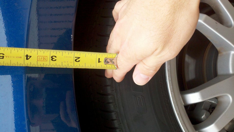

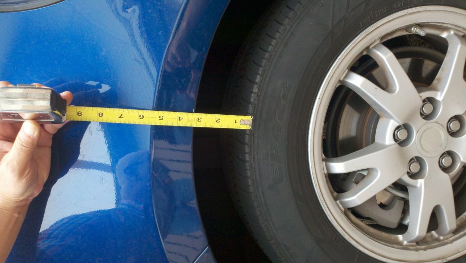

    I did installed the F-4136, I like it and I did the test show how it handle with 2 people in the Hatch back and 2 people in the rear seat, also a bag of salt for my water softener.
    212 lbs
    175 lbs
    175 lbs
    150 lbs
    40 lbs bag of salt
    total 752 lbs
    as you can see only drop about 1.5 inches with 4 people in the back and I only pump up 15lbs of both balloon.

    Air springs works great for a better ride. The more air, the stiffer the ride!! I,m pulling about 1900 lbs with about 30 to 35 lbs in the air springs. Don,t over do it, with too much air?

    understood, I won't do over 25 each side, that the max that said in the instruction, you have 30-35 lbs each side ?
