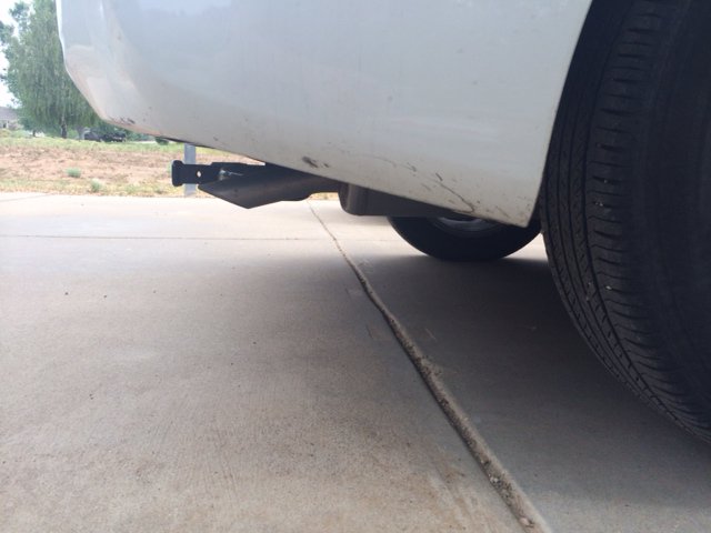

  6. SageBrush
    SageBrush Senior Member
    Jun 4, 2008
    11,627
    2,533
    Southwest Colorado
    Definitely the one to buy.
    I regret buying the older, cheaper version I bought that required the use of crappy thingies meant to splice into wires.

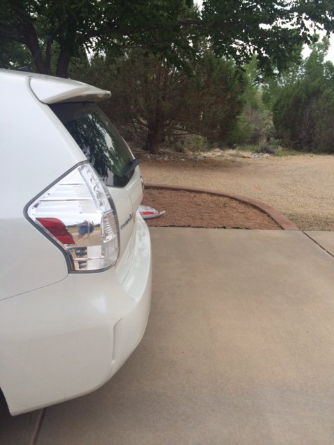

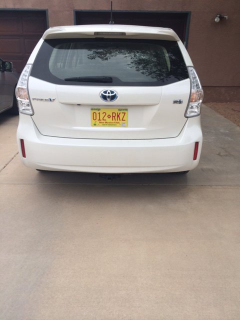

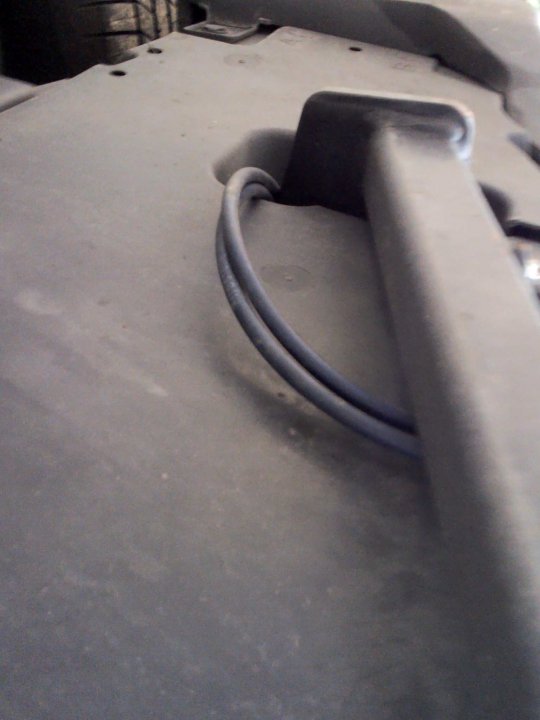

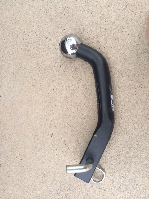

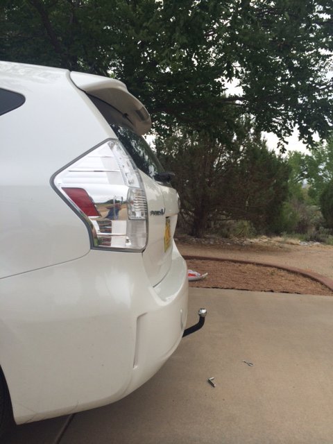

    People have posted that they choose based on how obtrusive the hitch is. I bought the Curt hitch and 'Euro Style' ball (#112761).
    I remove the ball when the hitch is not is use.
    Pictures #1 -# 3 are car with just the hitch, #4 is the Euro ball, and #5 hitch and ball installed.
    Hitch, ball and lighting kit cost $140 shipped from the truly wonderful hitchanything.com
    The lighting kit was lost in transit, so they overnighted replacement free of charge.

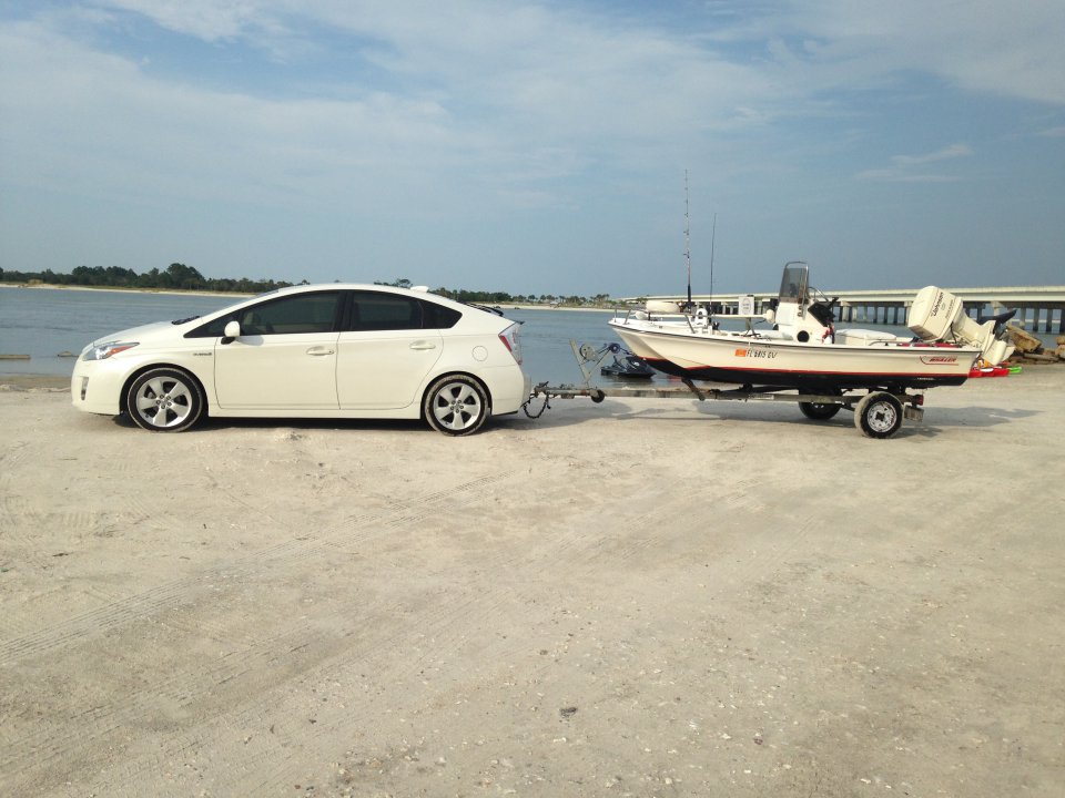

    This it what I pull
    Robin McGee and engerysaver like this.

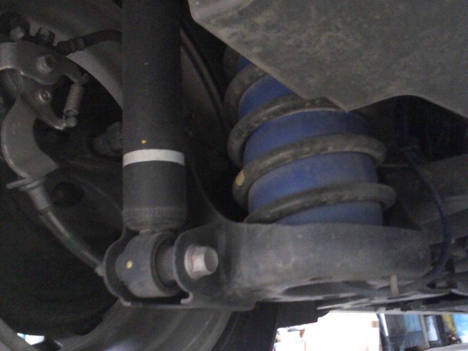

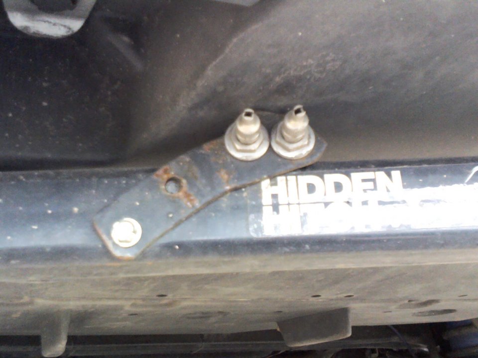

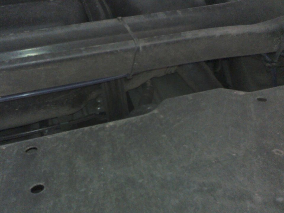

    Some pictures of my Firestone air springs # F4136.
    When you pull a heavy load, like I do, it is a "must have" for safety.(y)
    The Prius handles so much better; a smoother ride.:cool:
    E-TRAILER.COM has them for $ 104.65 as of July 28, 2014... It takes just a little air to pump them up!! 25 to 30 lbs of pressure. I'm going to say 2 1/2" to 3 " maximum on height.
    Firestone Vehicle Suspension for Toyota Prius 2011 - F4136
    If you like this info ..... Press Like ..... Thank You:)
