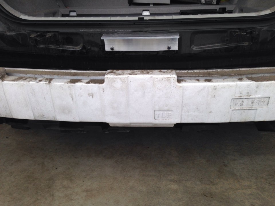

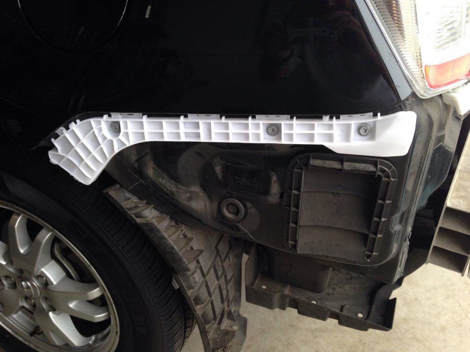

    I created a post yesterday on a mod I did on my sons 2010 Prius. The main issues for the Gen III cars is Toyota changed the clips and there is no support for the middle 2 ft of the bumper cover. There are only a few tabs and plastic clips that secure the sides.
    So any down ward force on the middle of the cover by the latch area can damage the cover tabs or the clips it self. I added a small bracket to take some of the load off the clips. If you need new clips the revised parts:
    #52575-47021 New Right
    #52576-47021 New Left

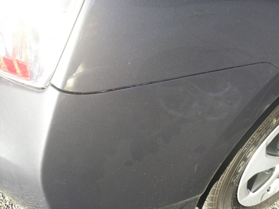

  18. Mendel Leisk
    61,595
    42,372
    Right side's a leetle worse on ours. But both sides have some opening of the gap.
    I'm not losing sleep over it, hey it's the "flagship" vehicle, according to dealership. :whistle:
