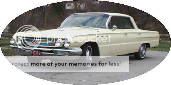

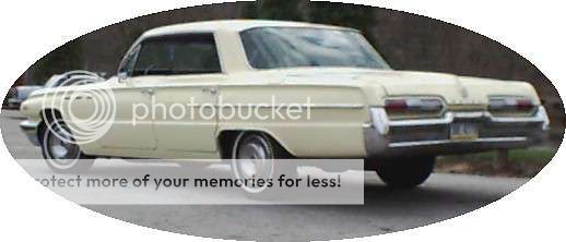

    My old car actually popped up on a web search when looking for the tranny pics. Actual pics of my old Buick my elder daughter affectionately coined "peemilk"...
    [​IMG][​IMG]
    and the website I uploaded them to (the Advanced Trust link is now defunct).
    1962 Buick LeSabre
