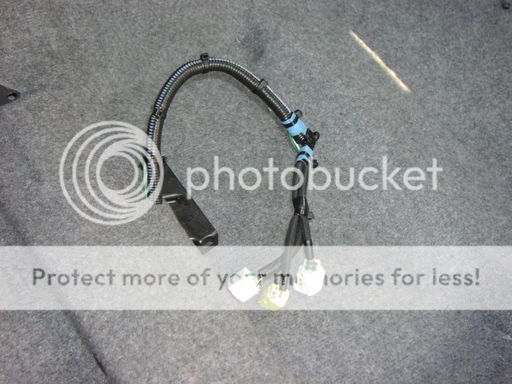

    Don't forget to get the wire harness...

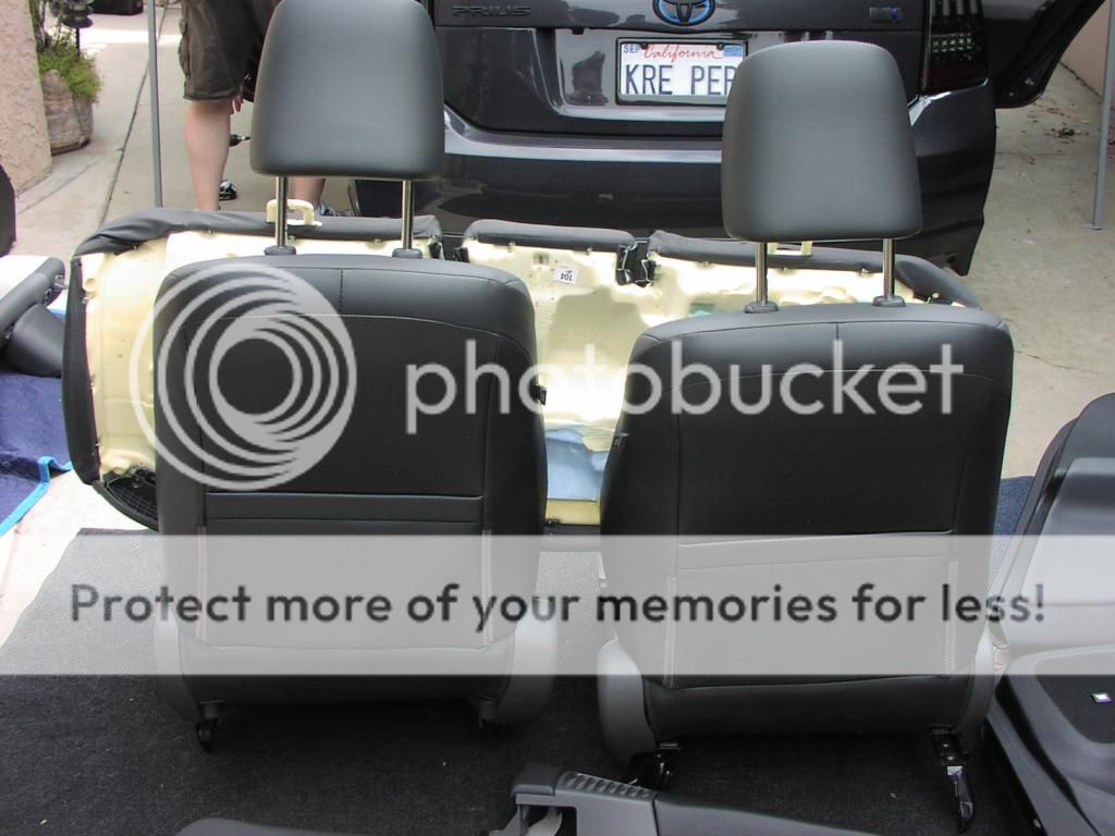

    Yep. You just got to get power to them, they bolt right in and work perfect ....... A PC member did the install with the oem wire harness. :whistle:(y)

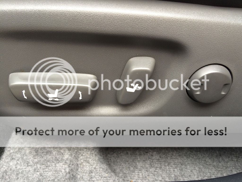

    Any chance of a picture of the power seat controls area?

    It's confirmed, the donor car was a Prius 5. Sorry, there was no write up just more pics. :)
    Is this what you're looking for ?
