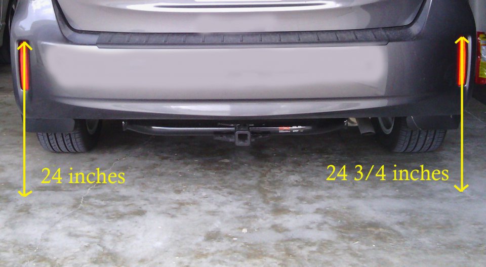

    Ok...I might be drinking way to many margaritas with summer now upon us in Florida but I would like to know if others with the v have this same leveling issue. I am one of those guys that is sensitive to things that are not level and sure enough when measuring the Prius I see that the left side is lower than the right.
    Can any of you take the same measurement points from the ground to the top of the reflector and see if I should lay off the margaritas or what could be causing this?

    24.5" on both sides. v 3

    24" exactly on both sides on my v5

    Dang! Thanks guys...Any reason why this could be?

    Do you drive alone? The springs might wear and sag more on the driver's side.
    It happens to me.

    Is it safe to assume that you've checked your tire pressures?

    Its probably worth checking out. The best way might be to have the dealer put it on a ramp rack and measure the height of each spring. No way should a spring be sagging after only a year or two.

    Yea...checked tire pressures all even...that would suck if the springs are sucking this soon.

    It would only take one bad spring. It does happen, though rarely. There's other things in the suspension that could do it too.

    Is that sort of stuff under warranty?

    I'd assume the suspension is under the 36/36 warranty. A spring isn't a big deal to replace.
