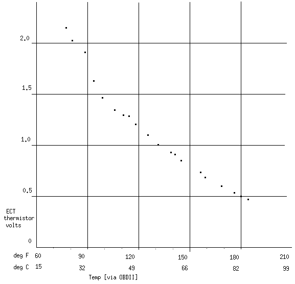

    The 'hack' is cheap and quick and might give you an early indication. Certainly it is OK with power off to measure the resistance of the transaxle thermistor pins w/o the ECU plugged in. If you see 1-3k ohm, it should be OK. If it is open, then determine if it is at the transaxle or in the wiring. ... That is the approach I'd take.
    The 1k ohm resistor looks like a 'cold' thermistor. If you jumpered it or put say a 100 ohm resistor in parallel, the ECU should see it as if the transaxle is 'burning up' and should throw a different code when you first start the car. This allows you to know the ECU was measuring the resistance.
    Another approach, the Graham miniscanner has the ability to read out MG1 and MG2 temperatures. You might check your scanner to see if there is a similar function. If one read 'stone cold' and the other say 10-15C (ambient,) then you'll have a positive indication of where the problem lies.
