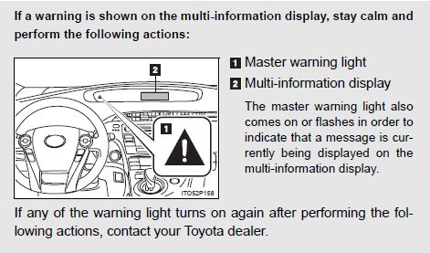

    Looking through the Owners Manual, there's multiple pages regarding triangle warning with exclamation mark, usually accompanied by a message in the upper dash display. Get it to the dealership?
