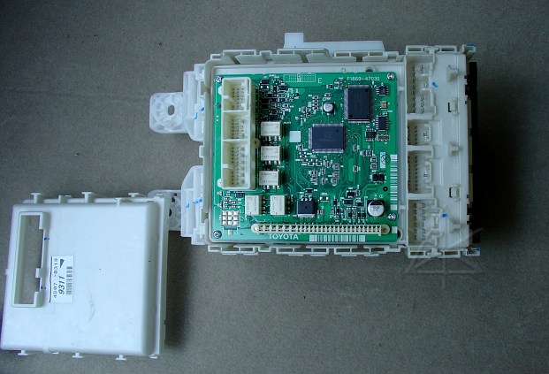

    Hybrid battery now charges perfectly, good gas mileage, but triangle remains with the other two. A buddy with techstream tried to diagnose it for me but couldn't get into BCM, so I figure it needs replacement.
    I've tried but can't determine exactly where the BCM is located.
    Can anyone help me out here? I am real happy with the progress I have made. This Prius has only 120k miles on it, so it is worth it to me to continue on this project as long as the cost doesn't get out of hand. Any advice?

    You might find hobbit's write-up helpful.
    If Techstream isn't communicating with it, you probably want to check through the possible reasons why, before just blindly deciding the ECU must be replaced. For that, you would want to look in the repair manual (more info) at the troubleshooting steps for failure to connect to the body ECU.

    Toyota's manuals call it the Body ECU, but if somebody wants to call it Body Control Module, that's not a huge obstacle to understanding what part they mean.
