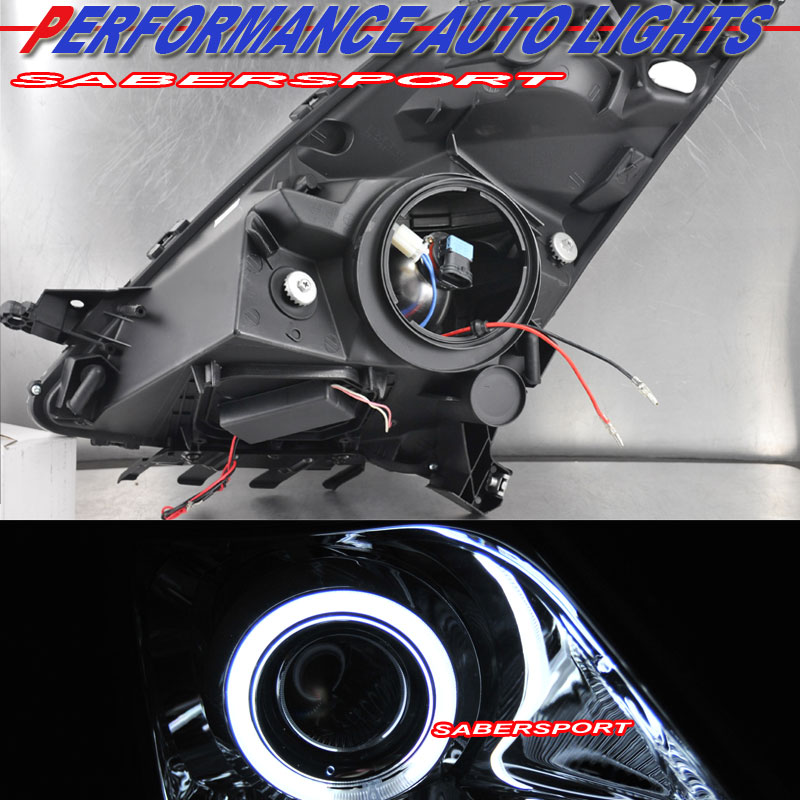

    I also noticed there are two turning wheels to adjust height. Why would you need two?

    are those rings led's?
    ??? if your car is loaded with stuff and the back of you car go's down and the front gets up then the light beam is not pointing at the ground but in the air.. so you need to adjust it.

    They are CCFL, brighter than LED they said. CCFL life cycle won't be as good as LED.... If they dies, I don't think you can replace them.
    Look at the pic below. It has two knots to adjust height. OEM halogen housing comes with one. I was wondering what the other one is for. Turn signal? It doesn't make sense.

    Up and down
    Side to side
    :0)

    It would be ideal to use brighter LEDs. The second knot could be to rotate (twist) the beam.
