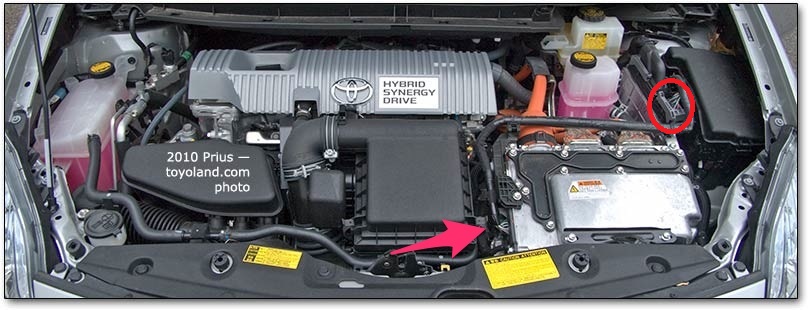

    Keep in mind too that there are more unexposed wires in other places as well. Look to the left of the inverter for example:
    I don't think this cover is really needed, if it was, Toyota would include it on the car as mentioned above.

    The ECU connector cover fits in the place referenced by the red circle...
    It is NOT where you placed the RED arrow.
    I used 3M fiberglass high temperature heat sealing tape to seal some other thinner wires, where a protector cover is NOT available.
    The ECU connector is NOT located where your red arrow is. ALL Gen III's 2010, 2011's 2012's, 2013's and 2014's are located all the way near the fender between the fuse box, the top right ECU in the photo and the pink colored coolant in the coolant tank. That goes for the Prius"v." the Liftback, and the Plug-in.
