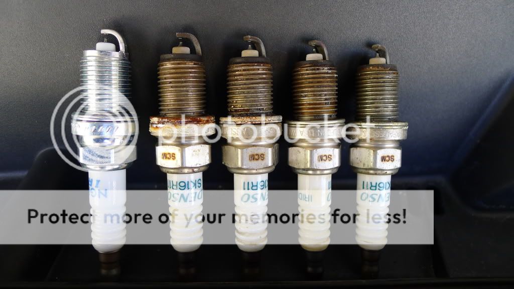

    Just finished changing all 4 spark plugs and cleaned the throttle body as well. The NGK's were already gapped correctly, and the gap of the old plugs were actually still good.
    Based on how clean plugs 3 and 4 are, I am assuming that the previous owner spilled some oil and it seeped into plugs 1 and 2.

    Spark plug comparison: (New/Cylinder 1/2/3/4)

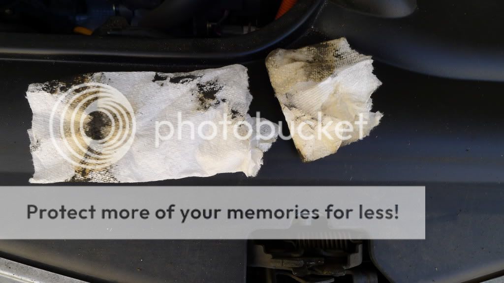

    All the gunk from cleaning throttle body:

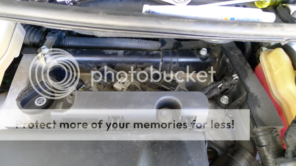

    Valve cover is fairly clean and didn't see any sitting water anywhere:

    A couple of cautions regarding spark plugs:
    1. Some of the pricey ones warn that they should not be regapped. It will damage them, I assume.
    2. Cleaning should ideally be with chemical solvent only, no wire brushing or sand blasting.

    Thanks for the caution Mendel.
    Iridium plugs can be gapped but require an unconventional way to avoid damaging the tip.
    I used "CRC Throttle Body & Air-Intake Cleaner" as the solvent. Sprayed it down onto the plate (avoiding the MAF sensor), stuffed a folded paper towel down there, and used a wooden chopstick to maneuver the paper towel around.
