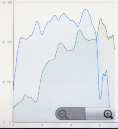

    The data doesn't show you anything about how steep my climbs are. Anyway here's a photo of the MyTracks app graph showing the trip to my destination, the return is backwards. For both legs I average 63 mpg, blue is speed, green is elevation.
    Total Distance: 12.29 km (7.6 mi)
    Total Time: 18:17
    Moving Time: 15:11
    Average Speed: 40.33 km/h (25.1 mi/h)
    Average Moving Speed: 48.52 km/h (30.1 mi/h)
    Max Speed: 88.34 km/h (54.9 mi/h)
    Min Elevation: 18 m (59 ft)
    Max Elevation: 82 m (268 ft)
    Elevation Gain: 82 m (269 ft)
    Max Grade: 4 %
    Min Grade: -5 %
    Recorded: Tue May 10 19:28:02 EDT 2011

    Thanks again! Sorry if I missed it earlier. What's your tire pressure?
