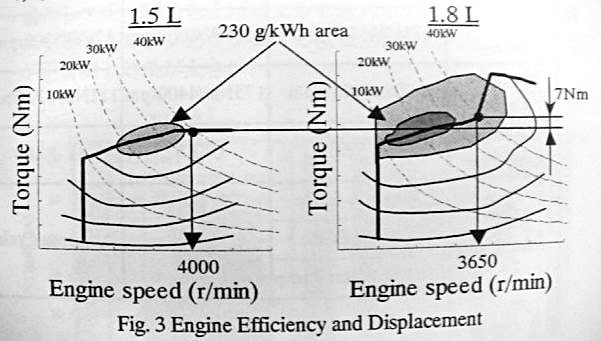

    OK, that diagram maybe gives me an inkling of what you're thinking.
    First, you do know that during the "Glide" part of Pulse and Glide, the engine is OFF, right? As in, zero RPMs, zero fuel, zero friction in the engine. That's where the energy savings comes from. So I might do an 8-second pulse, followed by 16 seconds of gliding, as an example. Doing P&G in a normal ICE vehicle is pointless for exactly the reasons you say; increased aerodynamic drag at higher speeds, as well as generally running the engine at less efficient points on the operating curve.
    So I don't know what the lower point on your chart is trying to indicate, but it seems to me like you think the engine is going to be still running, and at that lower point, during the glide, which is not the case. Or maybe you're forgetting that the Prius has a CVT, and can run at the optimal RPMs at any wheel speed - I basically alternate between running the engine at an efficient ~2,000 RPMs and coasting with the engine off. The ideal behavior is to basically sit at the most efficient point, and then coast with the engine off for as long as you can stand it.
    Here's the graph you really want, which IS Prius-specific, unlike yours. (Friendly jab. :))
    This is the BSFC map, with the 2nd gen on the left and the 3rd gen on the right. The two things this shows that yours does not is the fuel consumption (the shaded areas and solid curves), and the total power output (the dotted lines). The light gray blob on both charts is where it takes 230 grams of fuel to produce one kWh of power from the engine. The dark gray blob is where the Gen 3 takes 220 grams of fuel to produce the same.
    You'll notice that you don't want to be at the peak torque; this is actually a very inefficient place to be. What you want to be is right around the middle of that dark gray area; so around 2000 RPMs, producing 20 kW, using less than 220 g/kWh. The "Just Drive It" method is still pretty good; it'll probably put you at the very left edge of the dark gray or into the light gray, so using 220-230 g/kWh.
    So yes, it takes more kWh to do P&G; but because the fuel consumed per kWh is lower with P&G, there is an opportunity to save fuel, even if it takes more energy to the wheels.
    I've been doing P&G since basically the day I got my Prius, and I can tell you it can get pretty good results. (Not a guarantee - sometimes I do it poorly and I take a hit in the mileage, and other factors like short trips or highway mileage can negate the gains I get from P&G.) When I do P&G for a good distance, I can often get 60-70 mpg without much trouble - and that's in a congested suburban area. My wife does not use P&G, and her mileage on the same car in the same traffic is usually about 50-54 mpg.
    And while the subject of the video may not, I do pay very close attention to the power coming from the traction battery. I try to use almost zero power from it, and try to keep the SoC at 58-62%. My wife, on the other hand, often brings the car back with the SoC in the low 50s, so part of the challenge in getting my good MPGs is to replenish what she took out. :p
