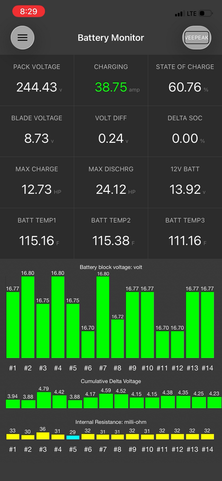

    The only thing that is concerning to me in the video of the new battery is the 30 to 36 milli-ohms internal resistance of the new battery blocks. That is high for a new battery. A new Toyota OEM battery would be about 25 to 27 mili-ohms.

    "The only thing that is concerning to me in the video of the new battery is the 30 to 36 milli-ohms internal resistance of the new battery blocks. That is high for a new battery. A new Toyota OEM battery would be about 25 to 27 mili-ohms." - what to do about it? should i claim fraud that they didnt build in a new battery?

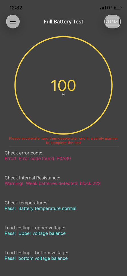

    i just run a dr prius test and see this issue:
    #7 Gerald10, Jun 15, 2026
  8. Brian1954
    Brian1954 Senior Member
    Jan 31, 2021
    2,671
    1,068
    South Central PA, USA
    There is no battery block #222. The P0A80 may be a permanent code and not an active code. You need a better scanner than Dr Prius to get the full story for the trouble codes.

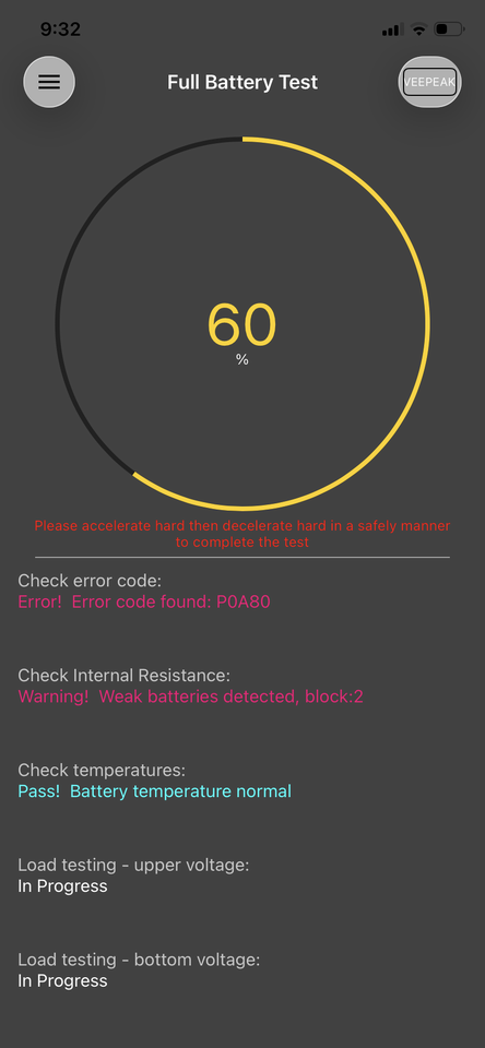

  18. Gerald10
    Gerald10 Junior Member
    May 23, 2026
    38
    i have P0A80 permanent code + and weak batteried detected, block: 2 but no triangle.
    see screenshot above.
  19. Brian1954
    Jan 31, 2021
    2,671
    1,068
    Like I wrote in post #8, the Dr Prius app is not very good for diagnosing trouble codes. You need a better scanner to do that. Do you have any other scanner? I have told you a number of times in one of you other threads.
    If you have a P0A80 permanent code and not a current code, the mobile technician that will be traveling to you will probably charge you for the trip. The Greentec Auto warranty for the battery only covers current codes, not permanent codes. Since you do not presently have the triangle warning light, you do not have a current P0A80 code. Expect to be charged for the mobile technician visit.
    You might want to talk to Greentec Auto about this before the mobile technician is dispatched. If the technician reads a P0A80 permanent code, he/she will not replace the battery.
