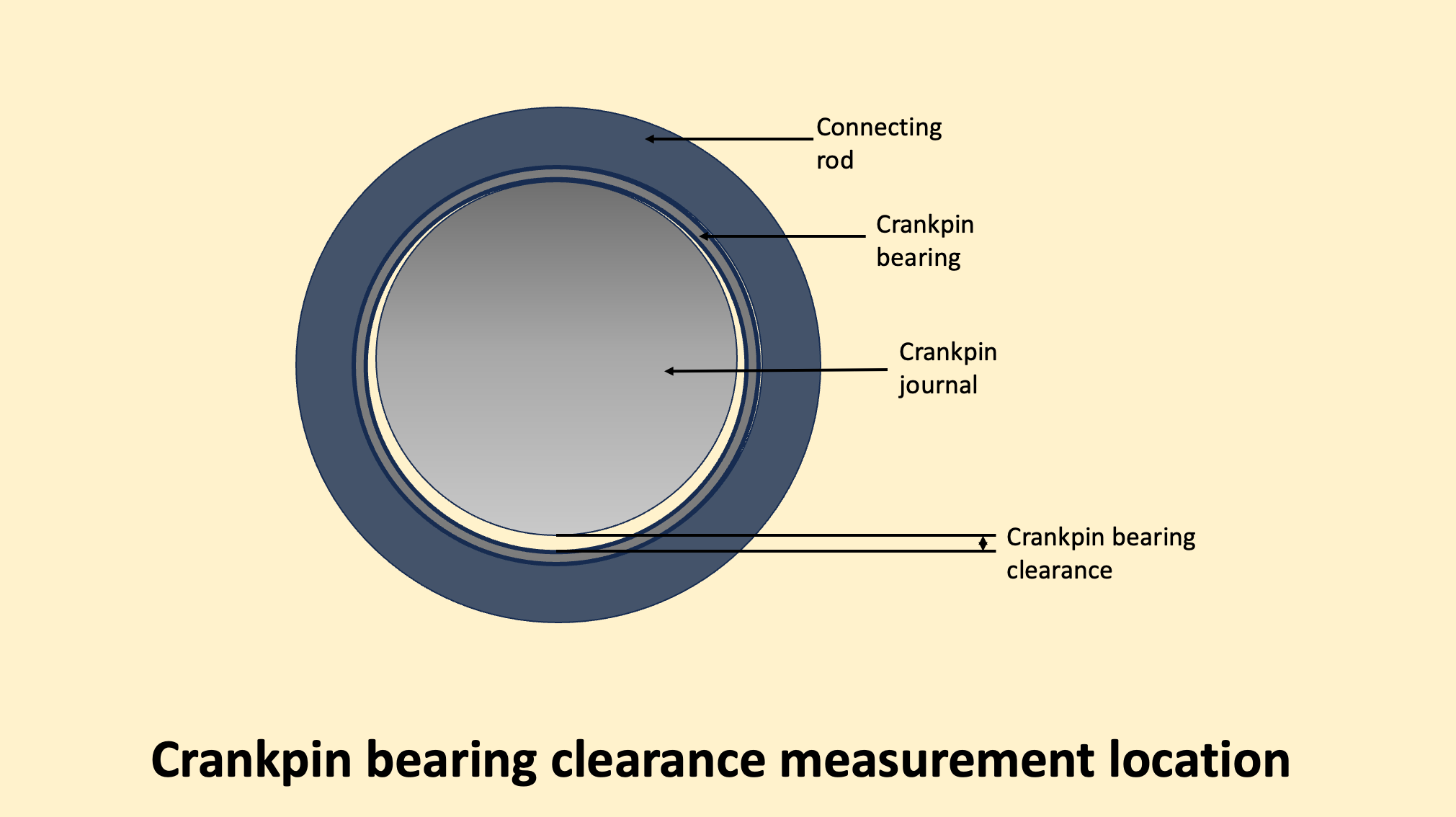

    Thanks, i learn something new everyday. Bearing clearance is something i never really thought about until now.
    This is what i found as a general rule of thumb for clearance and oil viscosity
    • 0.01 mm: 5W-20
    • 0.02 mm: 5W-30
    • 0.03 mm: 10W-30
    • 0.05 mm: 10W-40
    • 0.07 mm: 15W-50
    • 0.10 mm: 20W-50
    Deep-groove-ball-bearing-details-a-Sketch-b-Cross-section-showing-internal.png [​IMG]
