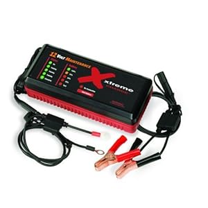

    I've said it before, and I don't mind a repeat, because it's worth the repeat. Get one of these:
    Amazon.com: Pulse Tech XC100-P Xtreme Charge 12V Battery Maintenance Charger Desulfator: Automotive
    You'll easily get an extra couple years out of the cheesy OEM aux battery. After you eek the extra couple of years out of the OEM, and the aux is mortally wounded change over the the Optima Yellow Top. You'll never look back.

    I have seen this one along with another desulfate/charge unit. Do you use this one regularly? How long has it lasted? I don't mind spending my money if I get quality and something that lasts along with doing what it claims to do. If I understand correctly, there are no adjustments on this unit, fully automatic. Is that correct? When you use yours, do you connect directly to the battery or to the jump point under the hood?

    I did see that post. I am looking for something that has a little more to offer than the 6Amp Diehard. The unit I referenced also has switchable amperage output as well as a desulfate system. If you do some research on batteries, you will find that all batteries tend to sulfate if they are not kept fully charged, and will sulfate heavily if you allow them to discharge. The charger I am looking at will at times bring a unservicable battery back to servicable use. It all depends on how much sulfate is on the plates.
    The unit will also charge up batteries as well as maintain them with a trickle charge, therefore it falls into the category of the type of charger I am interested in. I plan to use the charger on two separate vehicles, not just the Prius. FYI, Optima makes a real nice charger for your new yellow top. Expensive price though $199 on the website.
    Hope this helps ya in your quest for knowledge and research.

    We've been using the Extreme X for about 4 years now. It has a neat set of cables that allow you to do a permanent install on the terminals of your Prius. The cables have modular connector plugs in the middle of the cables that you can disconnect / dangle out of the car, to an easy-reach place. That way you can plug it to a power source without ever having to open up access to the car/battery. It was actually PriusChat's own Darrel (EVnut) that put me onto this model - which he uses for his RAV4-ev (see his web site: evnut.com and drill into the menus). I gave it a try after seeing that he swor by it - and how well it maintained his aux battery. We got a 2nd one for our electric Duffy party boat, which runs on a quantity of 8 six-volt lead acid "Trojan" style batteries. I rotate maintenance charges between the 4 pairs of Trojan batteries using our 2nd Extreme X . I'd of normally had to replace our 6v Trojan batteries by now, had it not been for the Extreme X. So yes, I'm very satisfied w/ them. I'm sure similar products work well, but the price for this sucker, as well as its 'set-it & forget-it' operation, makes it a bargain imo.
