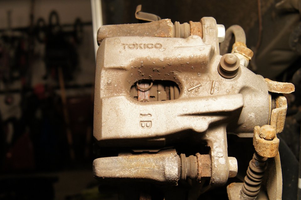

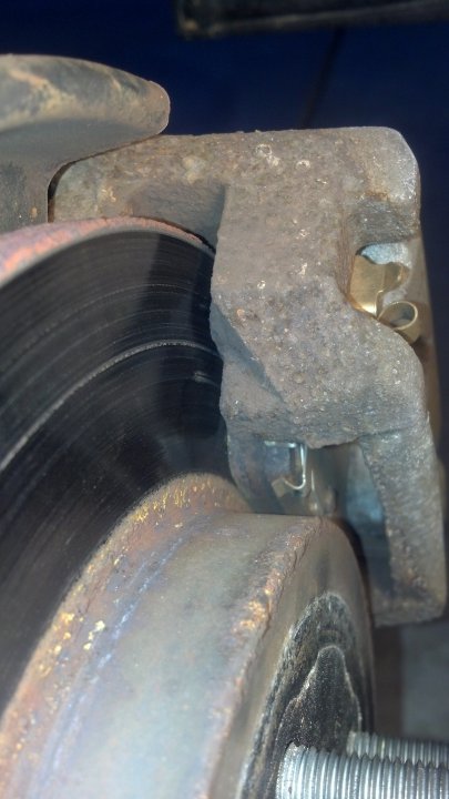

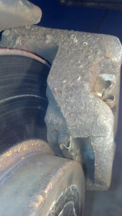

    This is what I found tonight- Look to be way over 1 mm that the multipoint inspection reported.

    OK I got the end on view with the camera - looks like there is plenty of that groove left. Either they were really trying to dupe me or they just put the the wrong information down. DSC06254.JPG

    Your pads look close to new thickness! Send them a link to these pic's?

    When the brakes are functioning correctly both the inboard and outboard pads will wear evenly. If you look closely at the wear indicator grooves in the center of your pads in the above picture, the groove in your outboard (left) pad is about half as deep as the groove in the inboard (right) pad. This means that your outboard pad is wearing about twice as fast as the inboard pad, indicating that the caliper is not moving as freely as it should and that the caliper slide pins and hardware need to be cleaned and lubricated. There is also a substantial amount of rust and corrosion in the above picture that should be removed. Your pads do not need to be replaced now, but your brakes do need to be serviced now to prevent further uneven pad wear which causes you to have to replace your pads sooner than if they wear evenly.

    I believe that the pads look to be uneven on that side in the picture because of an artifact from the angle I took the picture, couldn't get it straight on. But looking at them in person they were more even.
    I did do some more investigating on the other wheel because it started to squeak with non-regenerative braking. That side was wearing very unevenly - in fact it the outside pad wore at an angle, down to a point. So it was in fact down to "less than 1 mm" or even 0 at one point, but it was only 1 out of the 4 pads. I didn't replace the rotors at this time. So the dealership did catch a problem, but I'm not sure that justifies telling my wife to replace all the pads and the rotors (and yes I understand the pads always come as a set of 4 so its not like they could sell me 1 pad).
    So in the end I changed the pads myself with the help of a mechanic friend and will keep an eye on them for uneven wear again.
