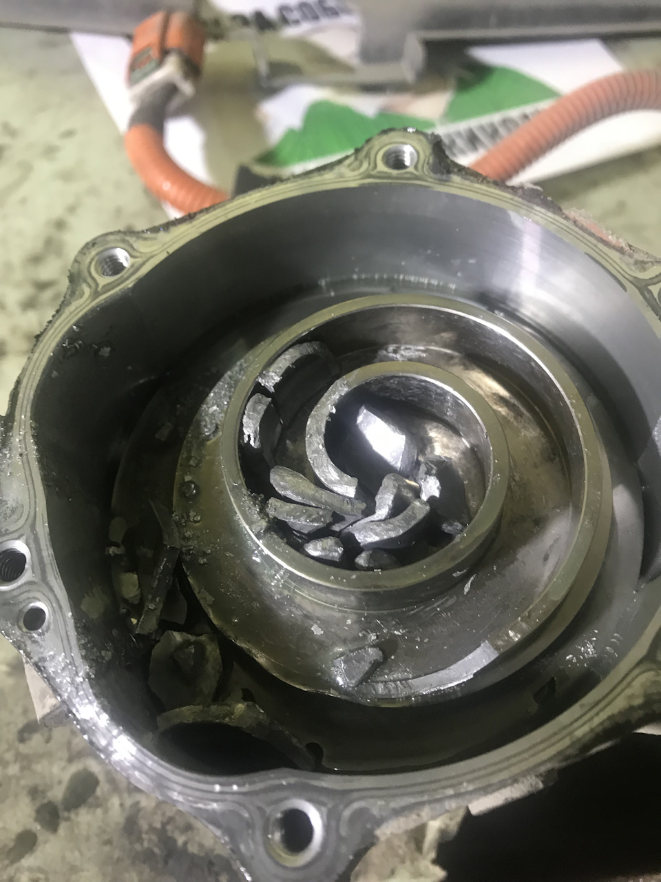

    Open the compressor cover and you will see something like this. Small chips from the impeller are carried throughout the system by the refrigerant.

    this happened to my 07 Camry hybrid, the ac compressor blew up inside. Metal fragments everywhere. Cause of the blow up, evaporator leaking slowly over time which depletes the refrigerant oil needed to lubricate the compressor.
    At a minimum you could just try buy an eBay used compressor (around $100+ or less) and then replace the condenser and drier (the new condenser will have the drier inside installed) Most of the fragments will get stuck in the condenser and in the drier. Just to be safe you can also replace the expansion valve but it's not that easy access.
    In my case I first purchased the ac compressor from eBay and then see if it runs well. I could still smell refrigerant in the cabin and ended up tearing the dash to replace the evaporator. Not a bad job but took me the entire weekend just for the evaporator.
