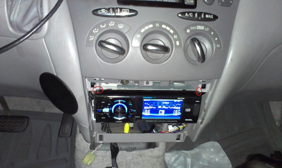

    I just installed an aftermarket radio for a customer. Rather than adapt an iPod to the factory radio just buy a $100 new radio from Crutchfield/Amazon with USB/Ipod/Iphone/Bluetooth etc. Install where the factory CD player goes. You'll need mounting brackets from the sides of factory CD, Make up an adapter harness that looks like the one linked below in the photobucket set and the clock in the factory radio and INFO buttons will still work. (but the factory RADIO will no longer work).

    I installed that same stereo. I love it. Bluetooth, aux and usb inputs, Bluetooth audio stream, Ipod controls, what more could you ask for $100? It is a great deal.

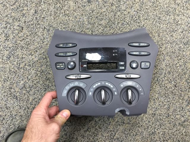

    Only risk in doing all this is some gen1 center dash panels shatter when pulling them off...this could add around $200 to your "upgrade" if this happens....mostly happens in dry climates where plastic is really brittle.
    (you have to pull the center panel forward a bit to access the factory radio connectors)If you remove the glovebox you can access the back of the factory radio from the side and save the center dash panel from getting broken.

    Just the lower dash panel near the ashtray (easy) and the center panel has to be pulled out a bit. This is the piece that can break if you're not careful. (First slide the hazard switch panel away from the dash to access two 10mm nuts then remove the screws at the bottom of the panel).
    Just lower/remove the glovebox and go in from the side to save damaging the large center dash panel.
    I did not add an amplifier. The aftermarket radio was sufficient for my customer.

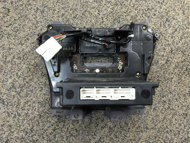

  19. 3prongpaul
    3prongpaul Hybrid Shop Owner, worked on 100's of Prius's
    Jul 18, 2010
    956
    735
    Boulder Hybids, Boulder, CO
    The clock and info buttons connect directly to the factory radio via the backside of the dash panel. Using the 3 wire "pigtail" allows you to feed power to that assembly so clock will still work. The orange wire makes no difference. I'll see if I have a radio/dash assembly out of car and post photos.

  20. 3prongpaul
    Jul 18, 2010
    956
    735
    Here's a (broken) gen1 dash panel, you can see the radio buttons and clock are separate from the radio/cassette unit which has been removed from the dash panel. The connector on the backside of this panel connects into the radio unit via the cars harness, and that's where it gets power from. The 3 wire pigtail plugs INTO the original radio in order for clock and info buttons to work. The three white connectors in a row at the bottom are for the HVAC controls.
