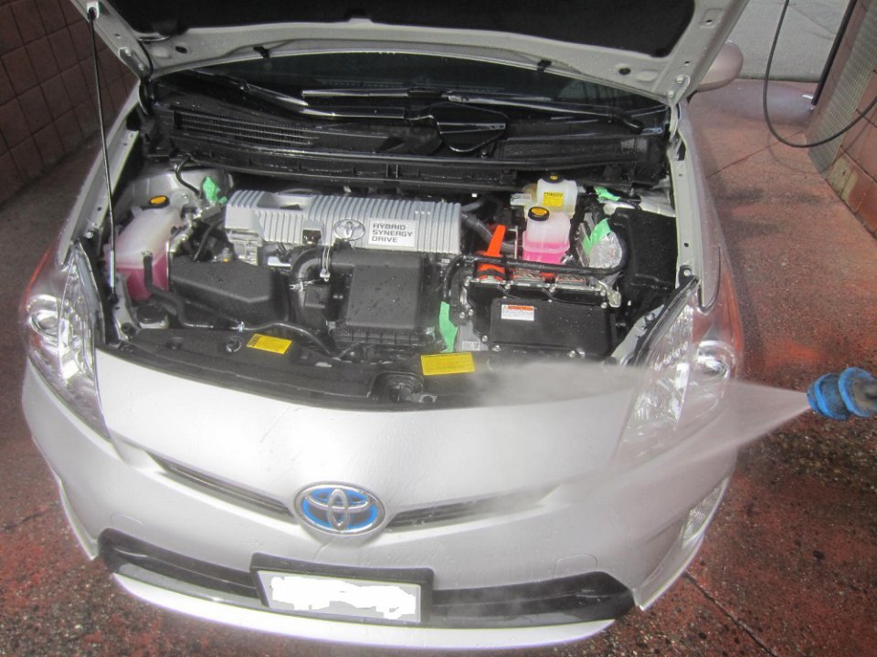

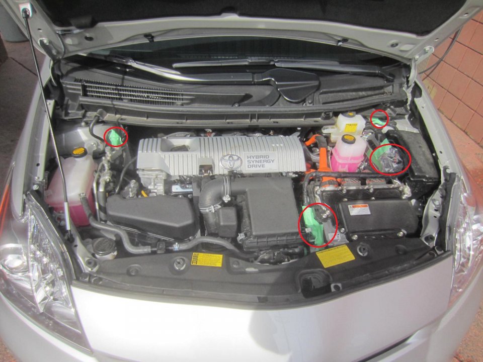

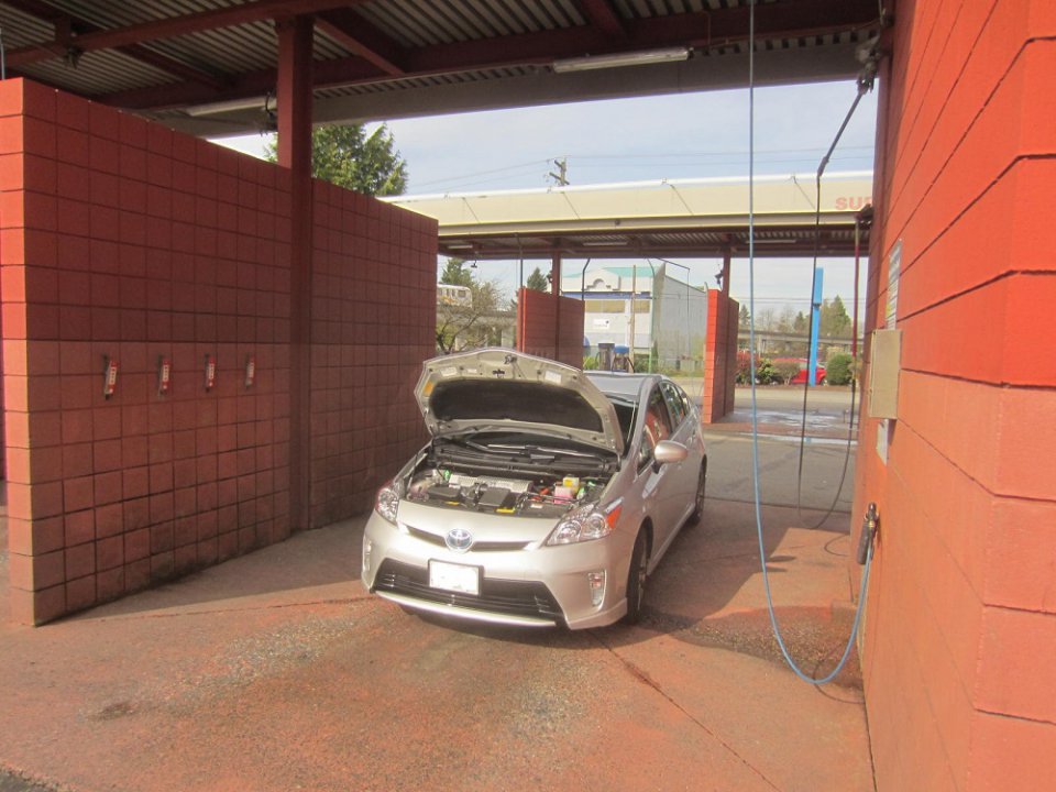

    Hi Guys,
    Thank you for all your input on this matter. So I couldn't stand the thought (as well as the smell!) of rat poop all over my engine bay. Today I decided to gently soap and powerwash inside the hood. The car still runs fine after (knock on wood!) and I urge others to use some common sense if they go this route.
    No specific order:
    1) protect all exposed connectors (see photos of highlighted red circles). There may be more that I missed such as headlight electrical connectors etc
    2) do this on a warm day so that the car can dry out (obviously don't do it in the middle of winter where the water can freeze, expand and cause more problems!)
    3) park the car outside in direct sunlight to speed up the drying process
    4) after the powerwash, drive the car to run your errands. Anything to keep the engine hot will speed up the drying.
    5) when taking the tape / plastic protection off of the connectors, be careful when pulling them off. The last thing you want to do is rip off the tape and damage the wires in the process.
    6) don't aim the powerwash nozzle directly onto important electrical parts. The goal is trying not to get water into sensitive areas.
    Good luck!
