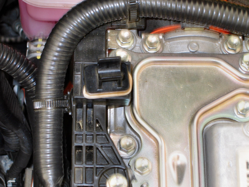

    I had a similar sound that sometimes occurred between 1600 and 1700 rpm (scangauge). It never sounded like an engine or mechanical problem, just a sort of tuned rattle. While touching and moving things in the engine compartment looking for the possible culprit, the one thing I was able to make noise with was the small black clamp that holds the rod that props the hood open. When the rod is clamped into it, it might act as a sort of tuning fork with a rattle.
    I wrapped a rubber band around the base of the clamp and haven't heard the sound since.
    I'll be tickled if this solves your problem as well.

    Consider yourself tickled. I've been having a rattle sound as mentioned by the OP. When you mentioned the hood rod, I thought, I just changed the air filter. Did I forget to snap it back in its holder? Yup, I opened up the hood and the rod was just dangling there on top of the ICE. No more sound. THANK YOU!:p
