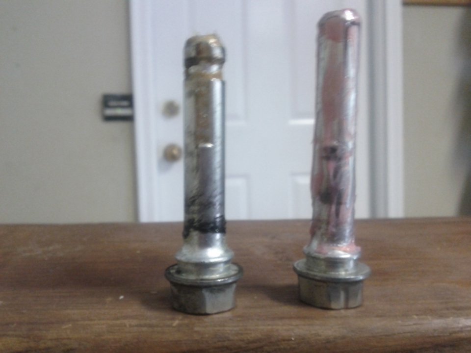

    These are my front pins, first time I pulled them. I forget now which is lower vs upper. There was no rubber on the one with the circumferential groove. I kinda doubt there's a rubber bit down inside the caliper, can't see it pulling off that easy. I've had them out once since, just recently, everything seemed fine, pads wearing uniformly.
    The car was brand new when we got it, 10 km on the odometer. Nobody else could have been at the brakes.
    (I didn't take pictures of the rear pins, guess I should have, lol. I'm predicting this fall to look at the rears, since it'll be 3 years, they're a bit out of sync. But if I've got time on my hands and get real curious I might do it sooner.)

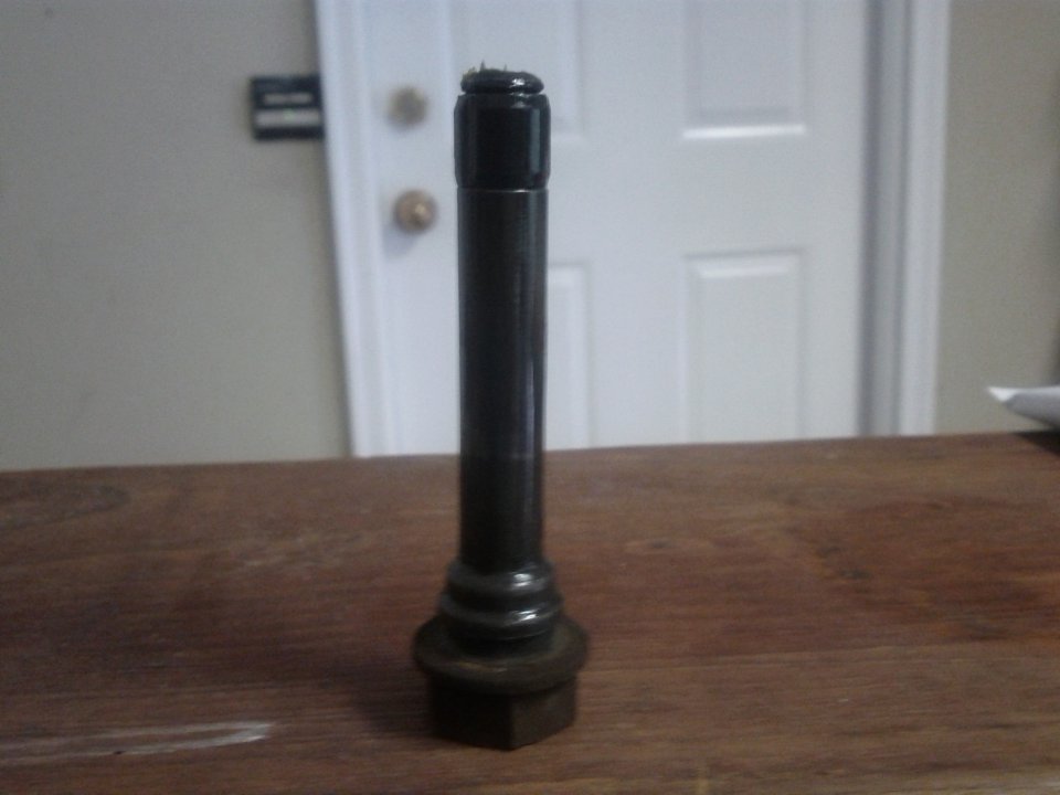

    here are my pictures and the whole write-up: Breaks inspection: my observations and surprises. | PriusChat
    front (new grease on the right):
    rear:
    at that time I was actually surprised the lower front pin had no rubber bushings like my other toyota cars. maybe they forgot to put them at the factory?
