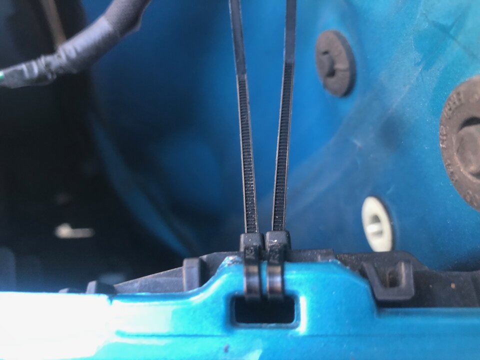

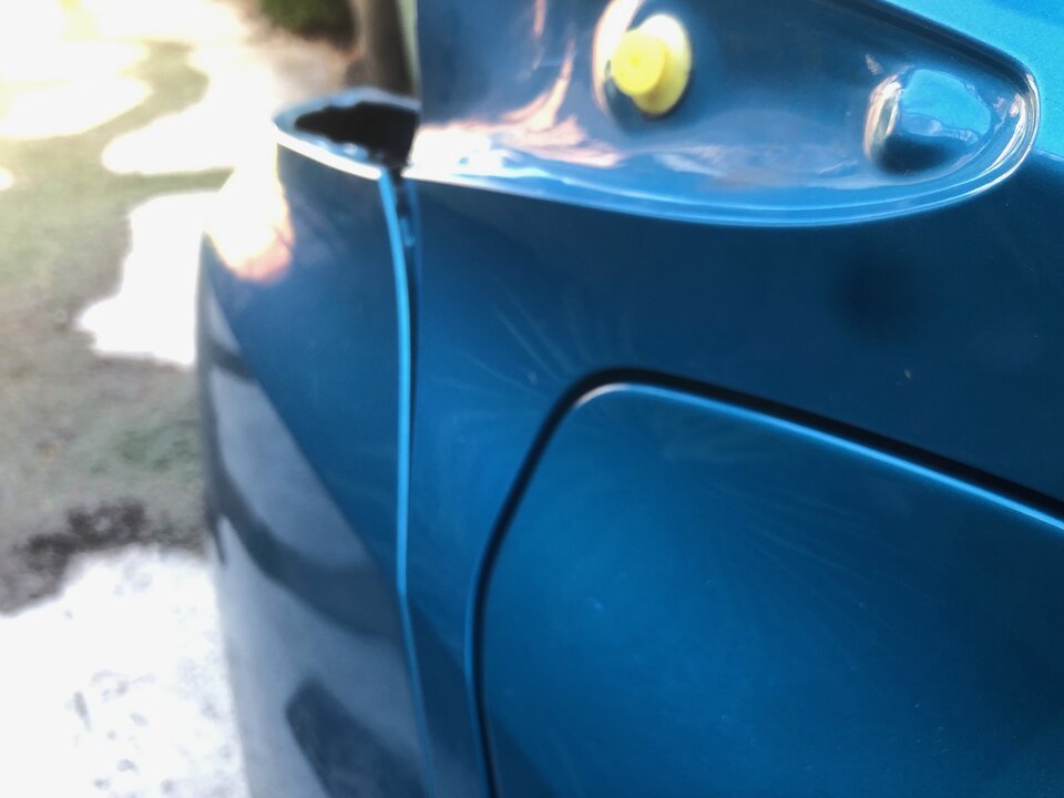

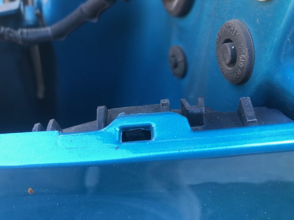

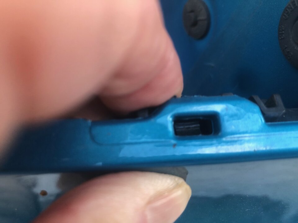

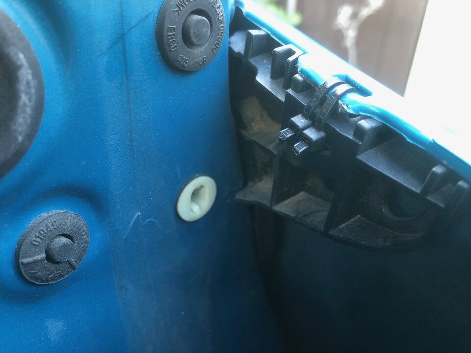

    This has been bugging me for a while, the rear bumper cover had popped out of its clip, most likely because someone was parking challenged- it turns out it was an easy fix and took 10 minutes and a couple of small zip ties to repair after removing the taillight.
